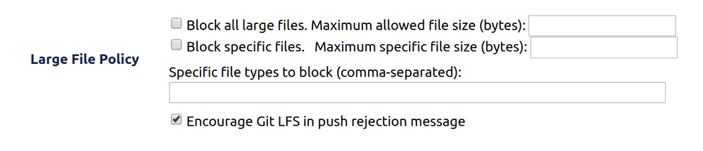

Julius Davies _GitBoost_com_
October 19, 2019
Hi, Pete,
Control Freak now supports your usecase (as of v2019.10.20):
In my opinion the bug you identified is unavoidable since it's coming from "git rev-list --objects" behaviour.
The only way I can think to workaround that bug is to run "git ls-tree -r HEAD" and look for all objectId matches.  Control Freak won't do that, however, because "git ls-tree -r" is pretty expensive (from an I/O and RAM perspective) just to defend against this one bug.
(Also, the workaround fails if the maliciously renamed file arrives in an earlier commit, anyway!)
October 13, 2019
Paging Adaptavist!  @Reece Lander _ScriptRunner - The Adaptavist Group_
Meanwhile, I plan to implement something for you in my free Control Freak plugin.  Stay tuned!
October 19, 2019
We've implemented this as of v2019.10.20 of Control Freak.
