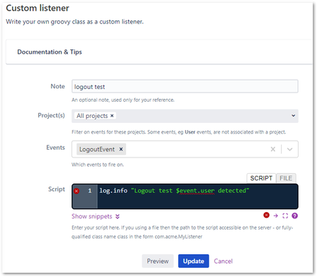

Well, the Script Listener tab is where you want to be.
  1. Create a new custom script listener,
  2. select LoginEvent or LogoutEvent in the  Events to listen too,
  3. Write a script for what you want to do when that event is detected
In my case all I did was write a line of text to the log:
Then I tailed the log while logging out with a test account and saw that line go in the log.
