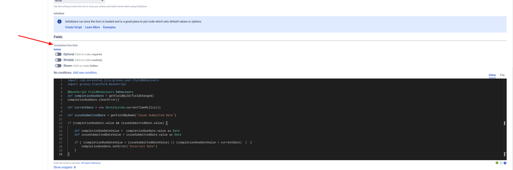

Below is the Server-Side Behaviour code for the Completion Due Date field:-
import com.onresolve.jira.groovy.user.FieldBehaviours
import groovy.transform.BaseScript
@BaseScript FieldBehaviours behaviours
def completionDueDate = getFieldById(fieldChanged)
completionDueDate.clearError()
def currentDate = new Date(System.currentTimeMillis())
def issueSubmittedDate = getFieldByName('Issue Submitted Date')
if (completionDueDate.value && issueSubmittedDate.value) {
def completionDueDateValue = completionDueDate.value as Date
def issueSubmittedDateValue = issueSubmittedDate.value as Date
if ( (completionDueDateValue < issueSubmittedDateValue) || (completionDueDateValue > currentDate) ) {
completionDueDate.setError('Incorrect Date')
Below is a screenshot of the Server-Side Behaviour configuration for the Completion Due Date field:-

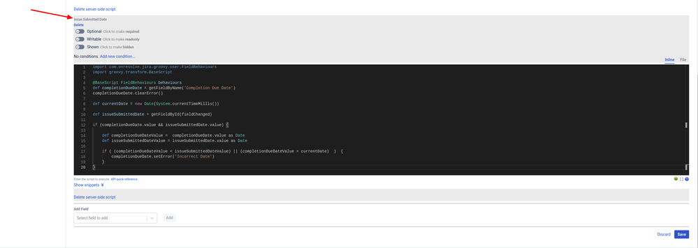

Below is a screenshot of the Server-Side Behaviour configuration for the Issue Submitted Date field:-

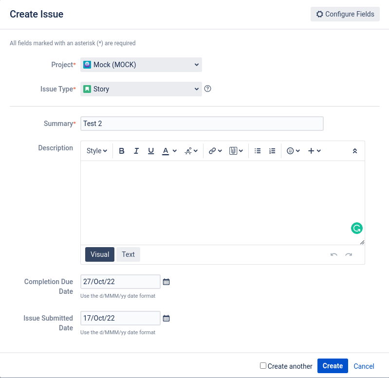

1. For the first test, the Issue Submitted Date value is set to 17 October 2022, and the Completion Due Date value is set to 27 October 2022.
There is no error in the validation because both conditions are met, i.e. the Completion Due Date value is after the Issue Submitted Date, and it is before or on the current date.

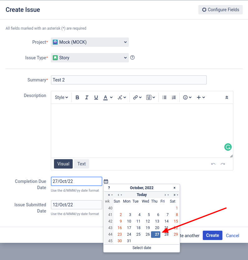

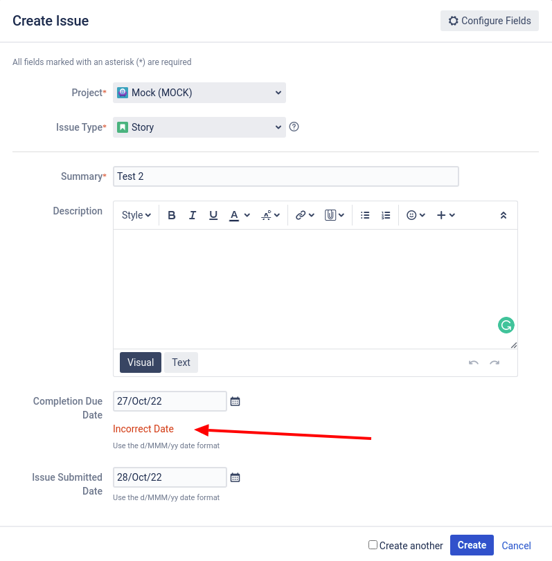

2. The Completion Due Date value is set before the Issue Submitted Date value for the second test. As expected, the Behaviour validation error message is returned.

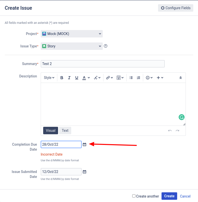

3. For the third test, the Completion Due Date is set after the current date, i.e. 28 October 2022.
As expected, the Behaviour validation returns the error message.

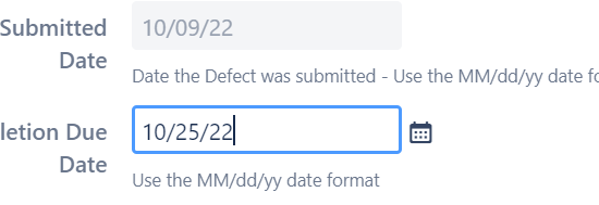

This works for the most part,I need an error in these scenarios
1: If the completion  due date is prior to Issue submitted Date . Which I  am getting .
 If the issue submitted date is October 11 and the Completion  Due date is October 3rd ,I am getting this error. _ Thank you for this.
2:  But for second scenario ,  I would like to get an error if the Completion due date is prior to current date but after the Issue submitted Date
For example:  If the issue submitted Date is Oct 3rd and if I enter  Completion due date as October 24 th  today (October 27 th) in the completion due date field , Need error for this.PNGthen I should get an error saying that "Completion date cannot be in the past"
looking for these two errors
1: "Completion Due Date cannot be prior to Issue submitted Date " Which I am getting .
2: "Completion due Date cannot be in the past" (In scenarios where the Completion due date is after Issue submitted date but prior to current date) Any dates entered after October 3rd and but before today.
3: The Completion due date (which is an  estimated date) can be a future date. User Can select  October 28 th and it should be fine.
