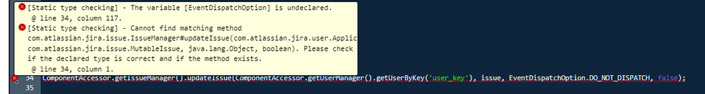

Hi @Antoine Berry , thank you for taking the time to reply, if I add the additional script from you, the following error occurs:

Hi @Antoine Berry , I managed to figure out what was wrong :)
Just needed this at the top:
import com.atlassian.jira.issue.IssueManager
import com.atlassian.jira.event.type.EventDispatchOption
and it worked perfectly!
Thank you so much!
