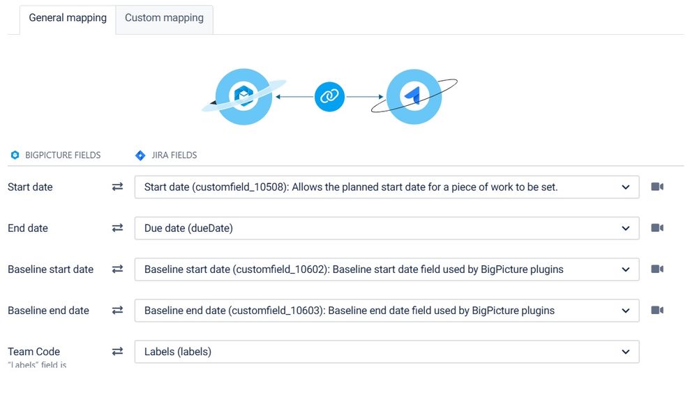

when i edit Due Date BigPicture automatically overwrite the value and bring back legacy date. I have already seen other topics with this but did not find a solution. My config is like below

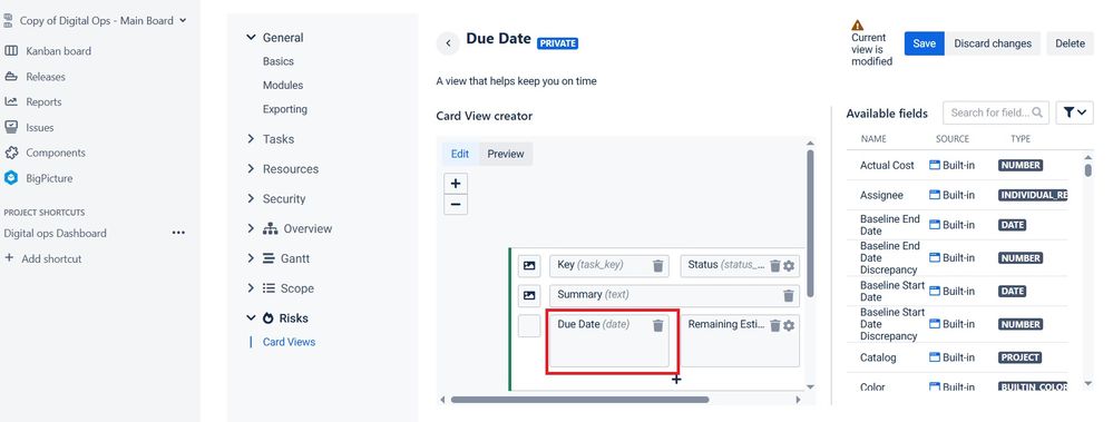

i run re-index process. Nothing happen BUT i can replicate the issue. The problem was only with legacy issues when Due Date was already provided. I opened new project from scratch and Due Date works fine without any Edit Issue. What i noticed between my NEW project and LEGAY one was this (below screen)
OLD project has such Risks configuration. My NEW project has no Due Date card under Risks.
I added this card to my project (same as above) and commit the change.
Then i tried to edit Due Date on my project and after 1 sec Due Date value is BACK to original value
Issue: i removed this Due Date Card from Risks card. Run Re-index.
Results: Ticket with uneditable Due Date cannot still be edited. Entire time there is original value od Due Date. But when i open another ticket and edit Due Date there is no any issue.
It looks like tickets which were fullfiled with Due Date value in the moment when Due Date Card is there (under Risks) they are no longer able to be edited.
