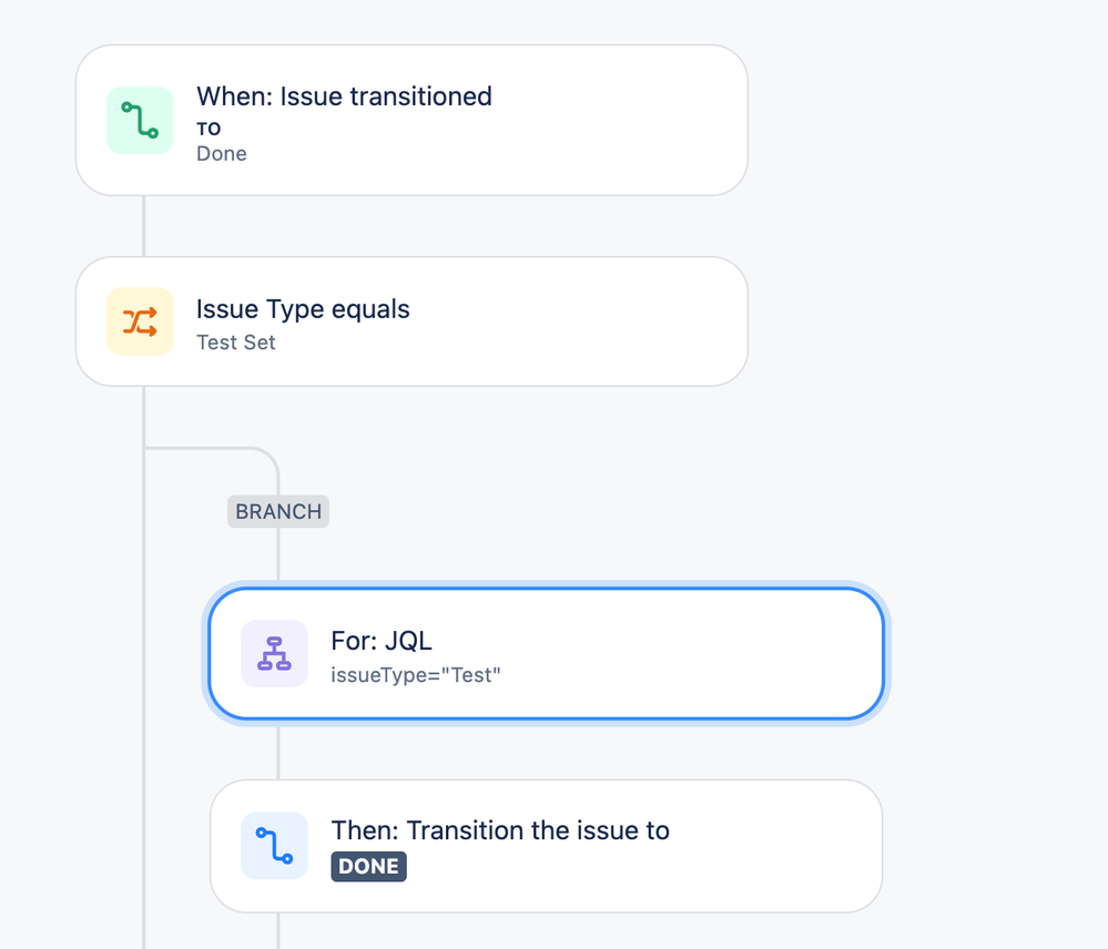

Ayush Singhal
May 27, 2024
Hi @Geethanjali Katagani
This is how my rule looks. Do you see any problem here?

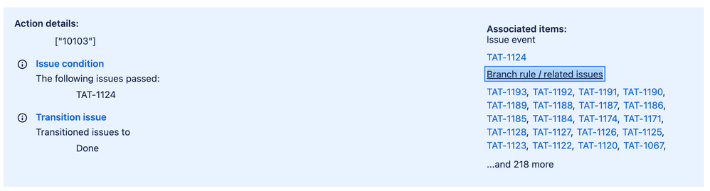

Here you can see TAT-1124 has only 4 tests but it transitioned 218 tests

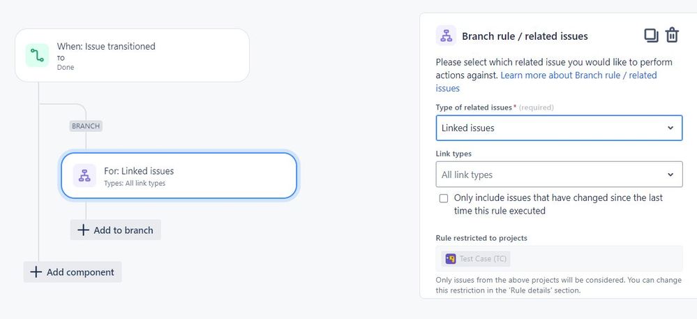

May 27, 2024
In the 'Branch' section, select the correct relation of the issues. After that, add the condition. Here, I have selected all linked issues of trigger issues.AC5.JPG
If you have any confusion, please share a screenshot of your ticket.

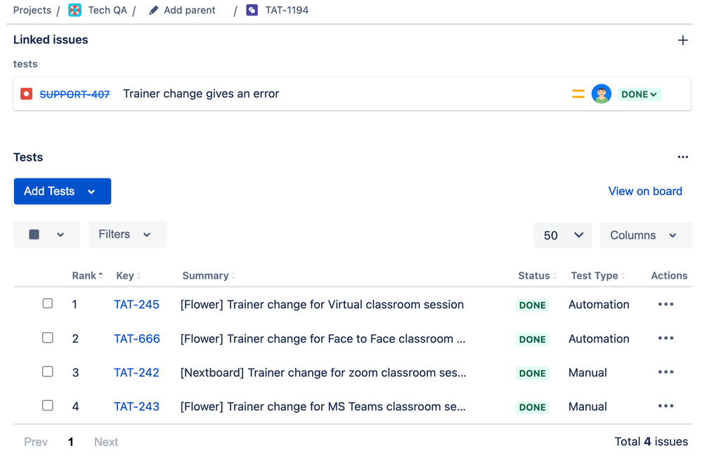

These tests are not exactly the linked issues to the Test Sets in XRay but are kind of subsets to them. Hence, I don't think 'Linked Issues' filter would work here. Below is the screenshot of the Test Set with some Tests
Below you could see the tests are not part of the 'Linked Issues' but are listed separately under 'Tests'

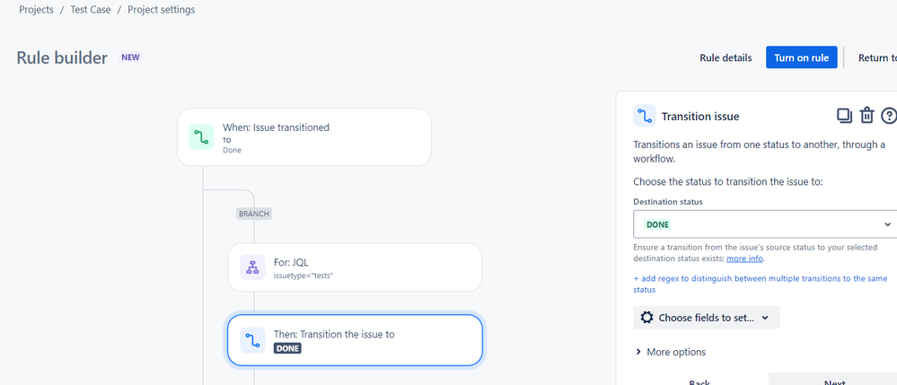

May 17, 2024
@Ayush Singhal ,
AC 3.pngPlease try to create automation like this.
Regards,
Geethanjali
Ayush Singhal
May 17, 2024
Thank you for the quick response. This solution does not work very well. It transitions all the issues with type 'Test' in the entire project to 'Done' while I am looking for a query that only transitions the 'Test' in that 'Test Set'.
