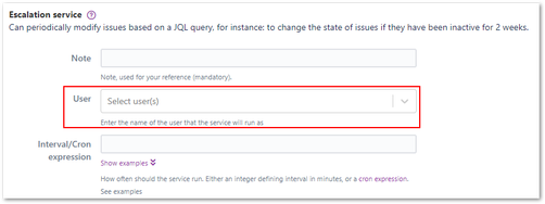

I think the fundamental issue you are seeing is with the selection of the user field in the escalation service configuration, not in the code. Try to re-select the user you want the job to run as.

PD Sheehan
May 26, 2020
If you set up the user correctly in the Job configuration, you don't need to use setLoggedInUser, scriptrunner will take care of that for you
