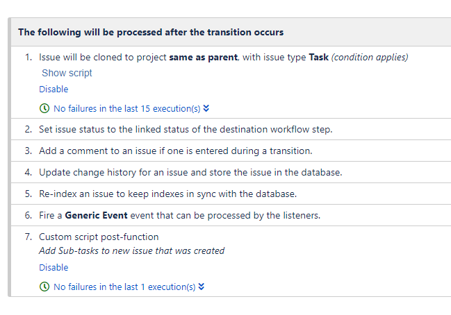

So we have a transition that when fired does the following:
  • Creates a new issue via clone of type "Task"  via a postscript step 1 (works fine)
  • Based on Field on original issue (that is copied to new issue) will create appropriate sub-tasks on the new issue via a second postscript step 7 (works fine for sub-tasks but not doing epic link to main issue created in step 1)
I finally deleted and rewrote the script in step 7 without actually setting the value on the new issue and it shows no errors.   But any time I had option of setting the epic link it would just fail.  So I am getting my subtasks but the new issue is not being linked under the epic it should.

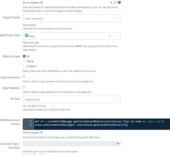

I think you might be complicating things unnecessarily.
In the clone post-function, the additional issue actions will have 2 variables available in the context: sourceIssue (the issue that triggered the workflow) and issue (the cloned issue created by the post function).
In your example, sourceIssue will be ABC-47 and issue will be ABC-96.
To set the epic link ABC-96 to ABC-40, it should be as simple as setting the epic link customfield from the source issue:

Tushar July 5, 2021
@PD Sheehan ,
I tried with your above solution to create a clone issue in post function and should be in Issue in Epic link. But only clone issue is working and not the linking to parent (issue in Epic).
PD Sheehan
July 5, 2021
You can try adding some debug messages to the "additional issue actions" and try to figure out why this wasn't working for you.
Try with the code below and then look at the resulting logs:
Note: This was initially posted before scriptunner started deprecating the built-in customFieldManager. The code before will should the current preferred method.
import com.atlassian.jira.component.ComponentAccessor
def epicLinkCf = ComponentAccessor.getCustomFieldObjects(issue).findByName('Epic Link')
log.info "Got Epic Link Custom field from target issue: $epicLinkCf "
def epicToLink = sourceissue.getCustomFieldValue(epicLinkCf)
log.info "The source issue being cloned has epicLink value of: $epicToLink"
issue.setCustomFieldValue(cf, epicToLink)
Tushar July 7, 2021
Worked with below script:
def epicLink = ComponentAccessor.customFieldManager.getCustomFieldObjects(issue).find { it.name == 'Epic Link' }
issue.setCustomFieldValue(epicLink, sourceIssue)
