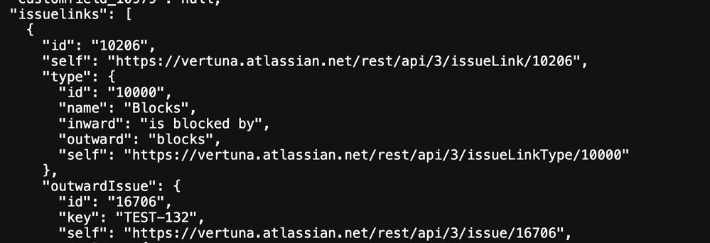

Yes, that's seems to be true... what I found though... is that you still can kind of select the id of the issue link, but you need to know the "link index"
Basically something like
issue.fields.issuelinks[0].id
Will get me the "10206"
Hey Alex,
what is the link index in this case? Is it like a incrementing number for each issuelink?
I dont know in which order the links are added in the JSON (Atlassian should know)
In my case it was the first link (index starts with 0)
