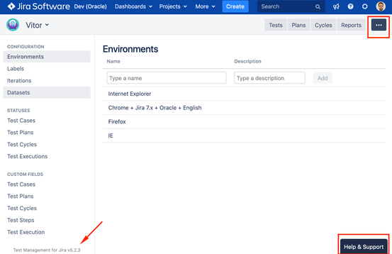

Hey Lahiru,
You can check that on the configuration area of the feedback panel:
