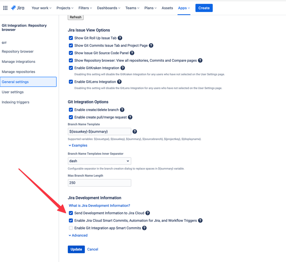

If you aren't seeing anything in the developer panel - it's possible that one setting in Git Integration for Jira is not enabled. Have your Jira admin go to the General Settings page and check for the "Send Development Information to Jira Cloud" checkbox. Is yours checked or unchecked? (it should be checked)

@Adam Wride  Turns out that we have the checkbox for "Send Dev Info to Jira Cloud" disabled.   We are definitely have a Jira Cloud instance also.   Can you tell me :  what are the risks of checking that box, if we have 800+ repos being indexed by this plugin?  Could it have any side-effects that might hurt existing users in our JIRA?   Our JIRA admin needs some reassurement about checking that box.
Adam Wride
August 17, 2023
@Jon.Austen - good to hear. This is very likely the reason that you are not seeing any information in the Development Panel.
In terms of risks, if you do not have any other plugin publishing to the Development Panel (it sounds like you don't) then the main "risk" would be in automated workflows that might trigger based on commits added/PRs merged/etc.
However - if your team hasn't been using any plugin with this functionality then it's unlikely that you have any workflows using these triggers. If your admin would like to check - they can look at the Automation for Jira administration screen.
If your admin would like to test out this functionality - they can test on a sandbox or on a free Jira Cloud instance to verify the behavior (I don't think this is necessary but I would understand why a seasoned Jira admin would want to do this).
Since the repositories are already getting indexed, you won't see any differences in behavior in terms of performance by turning on the "Send Dev Info" setting. Note - you will only see new activity after enabling this setting (for more information - see this help article). If it is important to see all historical information - your admin will need to remove the repositories and re-connect.
If you have any questions - you can reach out to us at support@gitkraken.com and we'll hop on a call with your admin.
Cheers,
Adam
Jon.Austen
August 25, 2023
Thanks @Adam Wride  ,  the change worked!    Now our huge organization has this feature.   Thank you.
