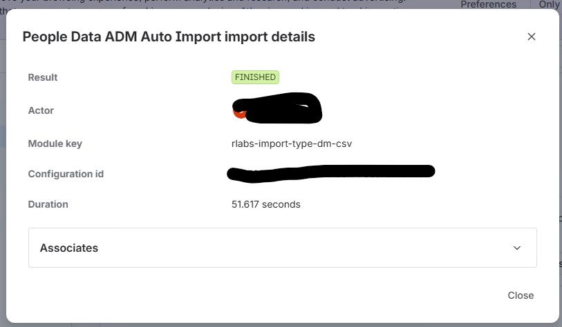

david_trevino_jackson_com
August 6, 2026
Your sync should (after first run) include a Configuration ID  which can be called from a scheduled automation.
Your automation should be able to kick it off by making a send web request POST to:
https://api.atlassian.com/jsm/assets/workspace/<YOUR_WORKSPACE_ID>/v1/import/start/<CONFIGURATION_ID_FROM_SYNC>
You'll need to define two headers for the call:
Accept                      Application/JSON
Authorization           <AUTHSTRING>
<AUTHSTRING> = Basic
followed by base64 encoded string typically user:token
Like Cristian Quiroz likes this
Dirk Ronsmans
August 6, 2026
Just beware that this will not work with the old Entra ID Beta integration.
The type of the import seems not to be supported. (but then again, just switch to ADM)
