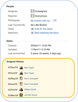

I wish I had a screenshot to show what the ScriptRunner script fragment produces, but this is what it resembles (Credit: PowerPoint Magic):

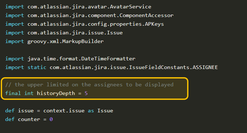

@Zita Bagi, That is the first of my listed concerns above. The list generated from the script-fragment does not back-date. Where you set the limit in the code is shown in the image attached below, but it only captures assignee history from the moment you apply the script-fragment. I assume you can change the limit to include more than 5, and I have not tested it to see how many can be listed before the list becomes excessive.
As far as to how I did it in my original post... I do not have a Jira environment on this network, so I created the reference image out of various images I found by performing a internet search and splicing them together (via PowerPoint) to resemble what it looks like on my production environment.
