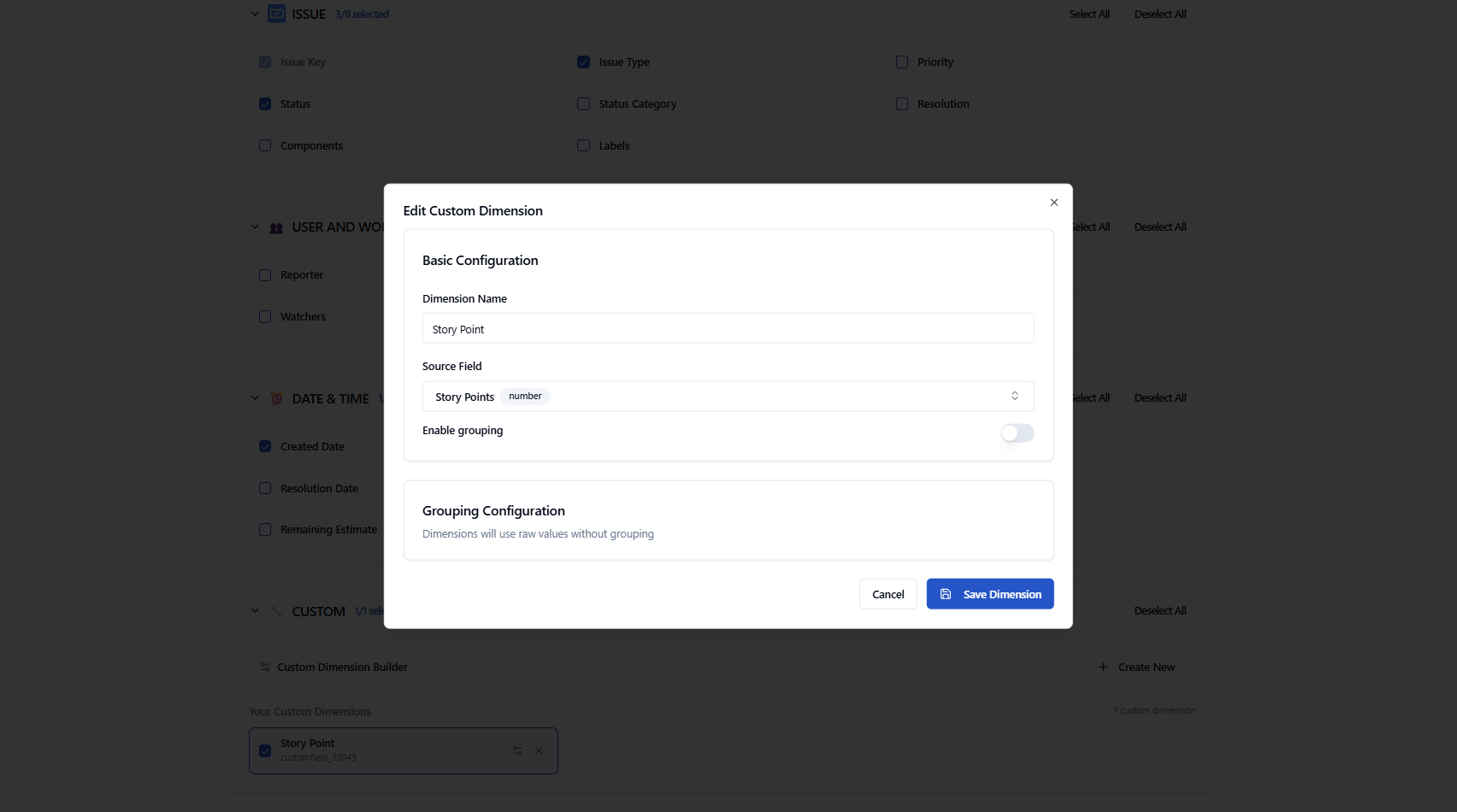

Start by selecting the Jira data source in Visionade and including the required numeric custom fields as dimensions. You can use the default Jira dimensions provided, or create custom dimensions from any of your available fields. In this example, I’ll create a custom dimension for ‘Story Point’ - a numeric field.

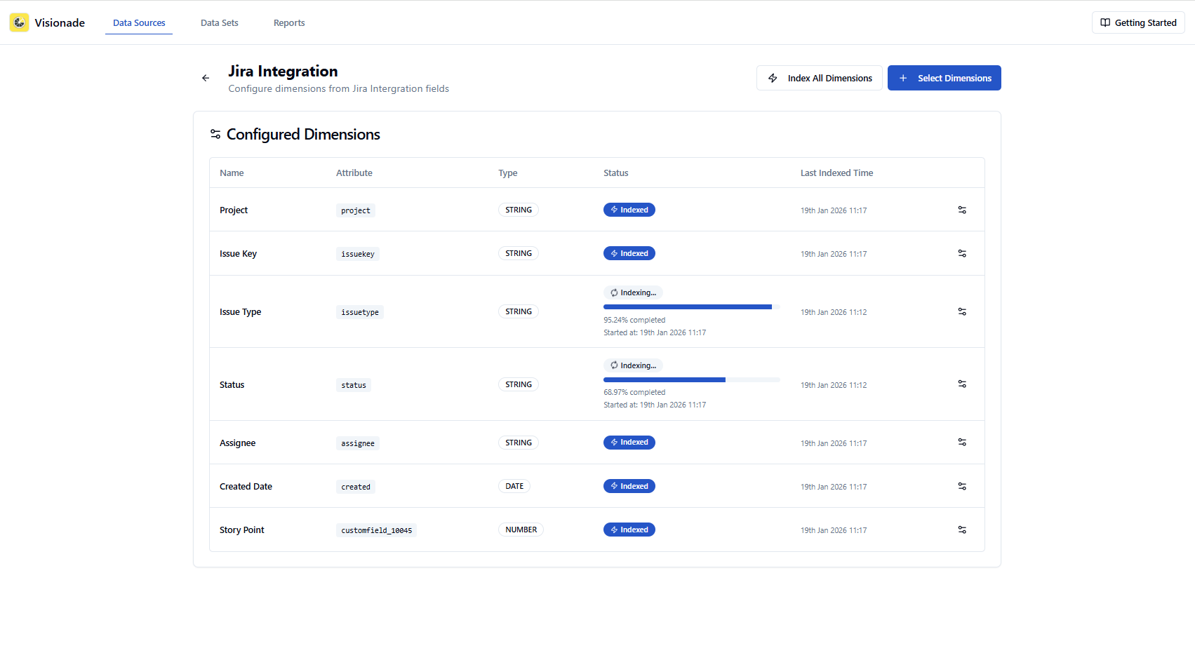

Index those fields so their values are available for aggregation across projects.

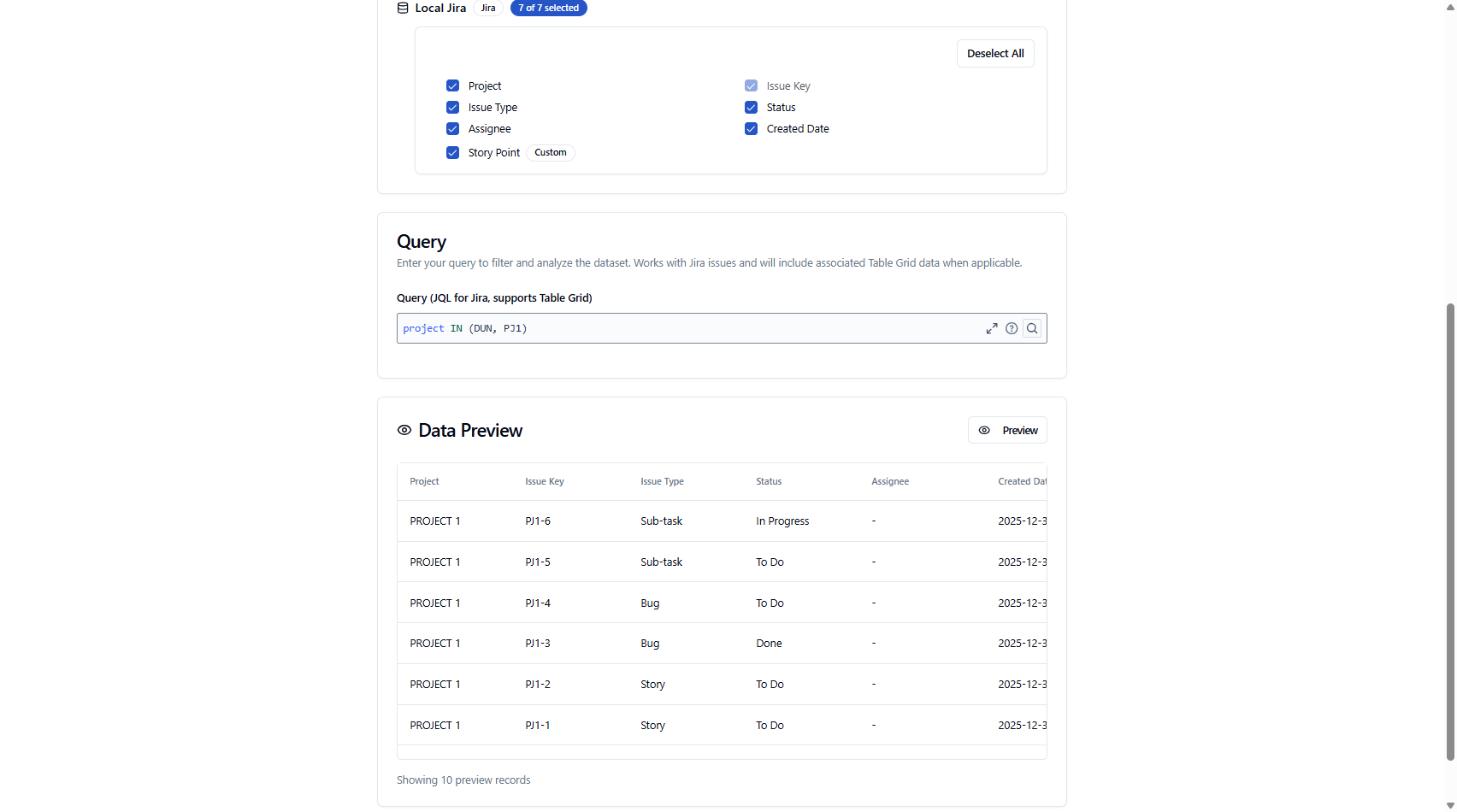

Create a Data Set with a cross-project JQL filter covering all projects where the quality metrics exist.

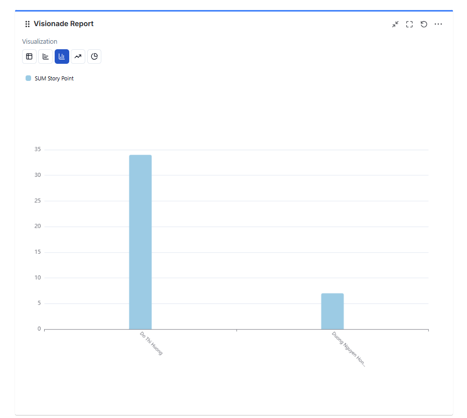

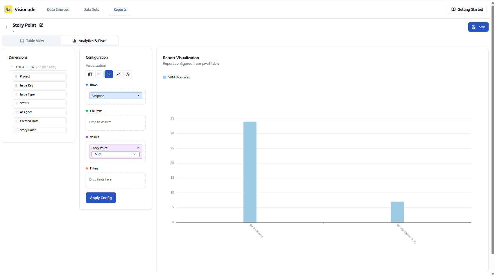

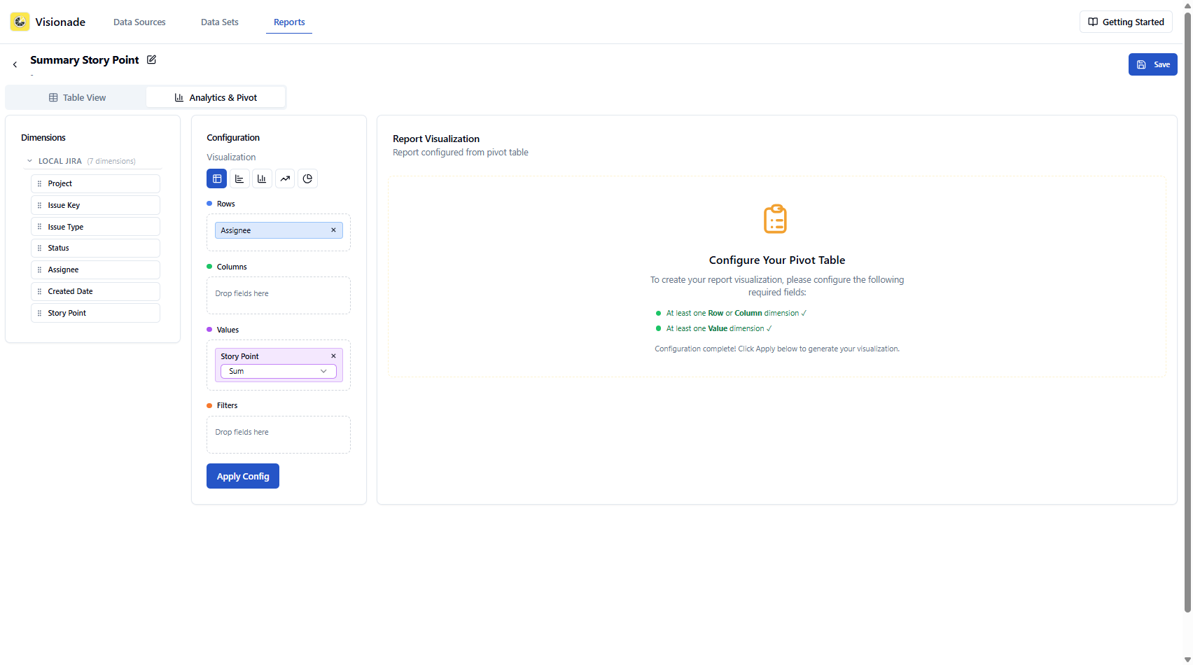

Build a report from that Data Set, drag the numeric custom field into the Values area and apply an aggregation such as Average, Sum, or Max.
Choose a Column, Bar, or Line chart so the aggregated numeric field is rendered on the axis.
Add the saved report to a Jira dashboard using the Visionade Report gadget.
Result
After setting this up, numeric quality metrics could be charted cleanly across projects without custom exports or per-dashboard hacks. The same Data Set and aggregation logic could be reused as reporting needs evolved.
