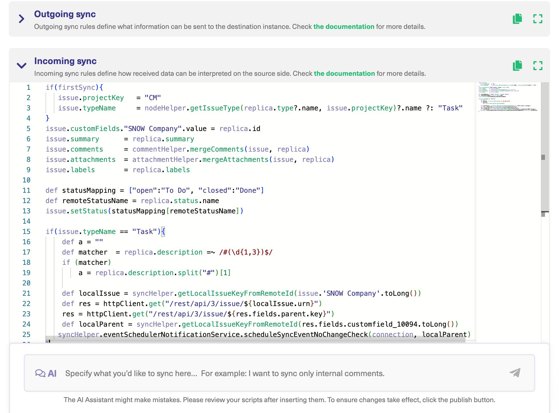

Jira Incoming Sync
if(firstSync){
  issue.projectKey   = "CM"
  issue.typeName     = nodeHelper.getIssueType(replica.type?.name, issue.projectKey)?.name ?: "Task"
issue.customFields."SNOW Company".value = replica.id
issue.summary      = replica.summary
issue.comments     = commentHelper.mergeComments(issue, replica)
issue.attachments  = attachmentHelper.mergeAttachments(issue, replica)
issue.labels       = replica.labels
def statusMapping = ["open":"To Do", "closed":"Done"]
def remoteStatusName = replica.status.name
issue.setStatus(statusMapping[remoteStatusName])
def userMap = [
  "syed-majidhassan" : "syed.majid.hassan@exalate.com",
  "dhirennotani19" :"dhiren.notani@exalate.com"
def defaultUser = nodeHelper.getUserByEmail("defaultuseremail")
issue.assignee  = nodeHelper.getUserByEmail(userMap[replica.assignee?.username]) ?: defaultUser
if(issue.typeName == "Task"){
    def a = ""
    def matcher  = replica.description =~ /#(\d{1,3})$/
    if (matcher)
        a = replica.description.split("#")[1]
    def localIssue = syncHelper.getLocalIssueKeyFromRemoteId(issue.'SNOW Company'.toLong())
    def res = httpClient.get("/rest/api/3/issue/${localIssue.urn}")
    res = httpClient.get("/rest/api/3/issue/${res.fields.parent.key}")
    def localParent = syncHelper.getLocalIssueKeyFromRemoteId(res.fields.customfield_10094.toLong())
  syncHelper.eventSchedulerNotificationService.scheduleSyncEventNoChangeCheck(connection, localParent)
With this snippet, you can fetch the status of any issue (task) and have it reflect on the GitHub issue. You will also be able to indicate the assignees and users by email and username.

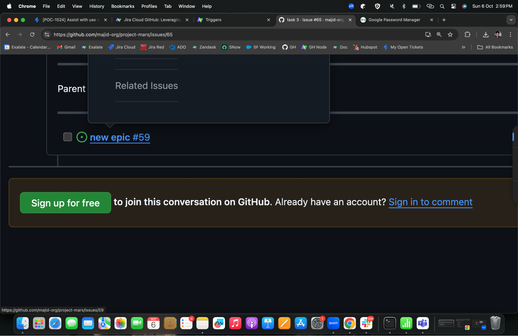

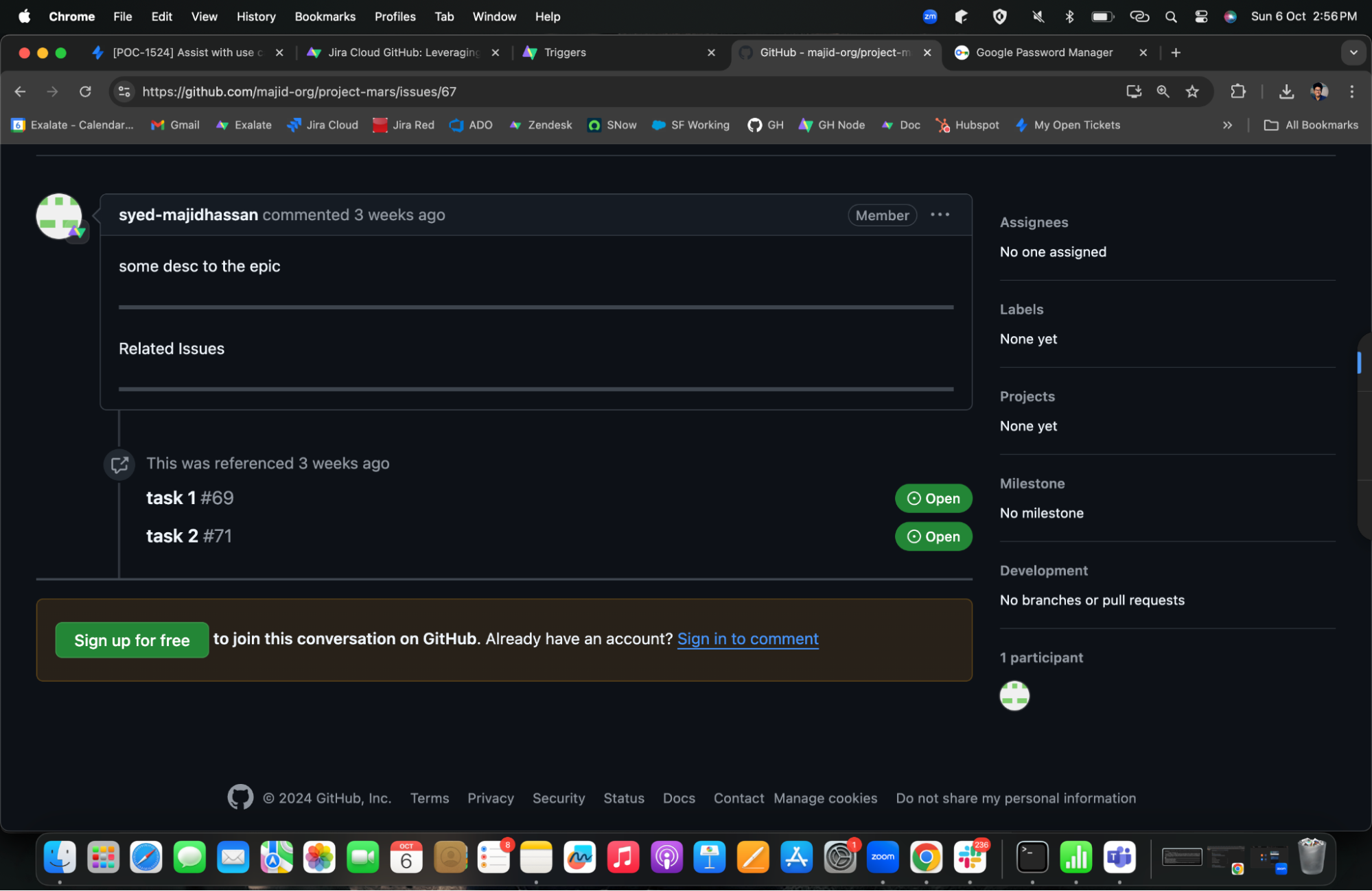

On the GitHub issue, you can find a link to the Epic added as a task list. This will appear as an active link.
When you click on the Epic link, you can see the tasks and the ID reflected as task lists. The status of each task will also appear on the issue.

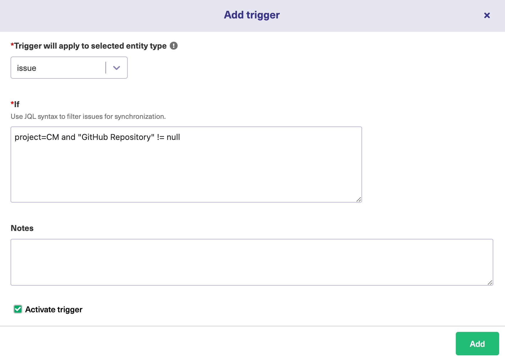

project=CM and "GitHub Repository" != null
This trigger establishes the condition that if the Epic is from the project named “CM” and the GitHub Repository is actually active.
