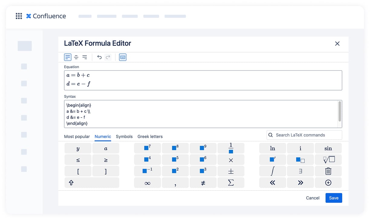

The align environment lets you write several equations aligned on the & symbol:
\begin{align}
a &= b + c \\
d &= e - f
\end{align}
This renders two aligned equations with equal signs lined up.
Tips:
  • Always use double backslashes (\\) to break lines
  • Use & to align equations on equal signs or any other chosen symbol
  • Use \text{} to add words or comments inside math blocks

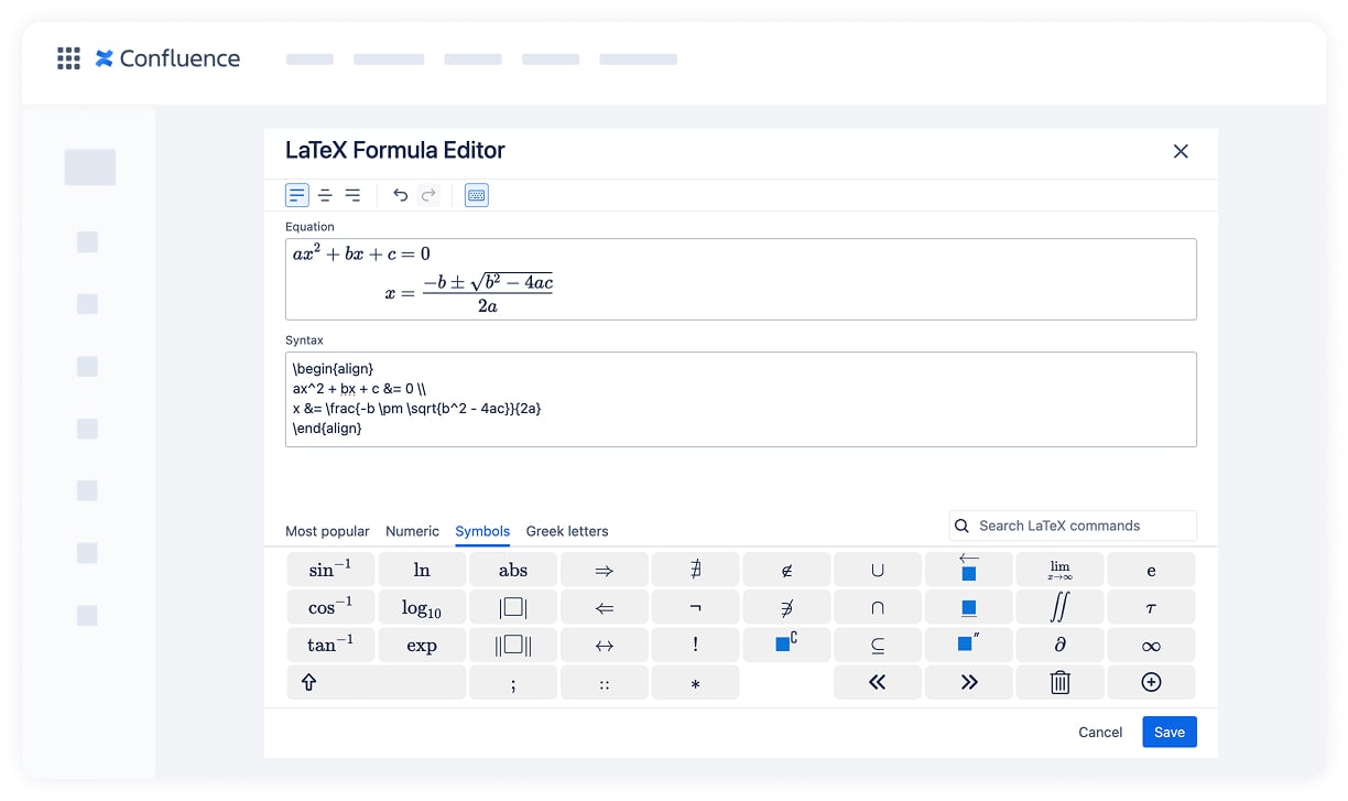

Example 1: Basic alignment on equals sign
\begin{align}
ax^2 + bx + c &= 0 \\
x &= \frac{-b \pm \sqrt{b^2 - 4ac}}{2a}
\end{align}

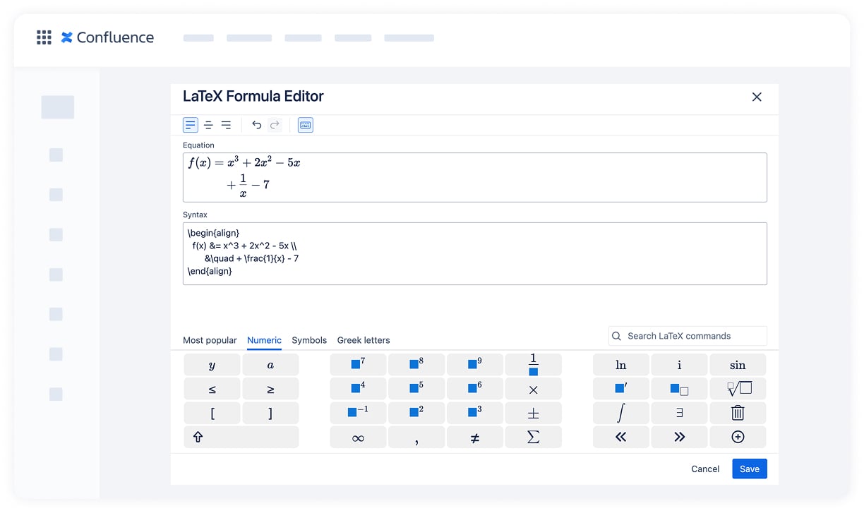

Example 2: Long equation split across lines
Useful for breaking up lengthy expressions:
\begin{align}
  f(x) &= x^3 + 2x^2 - 5x \\
       &\quad + \frac{1}{x} - 7
\end{align}

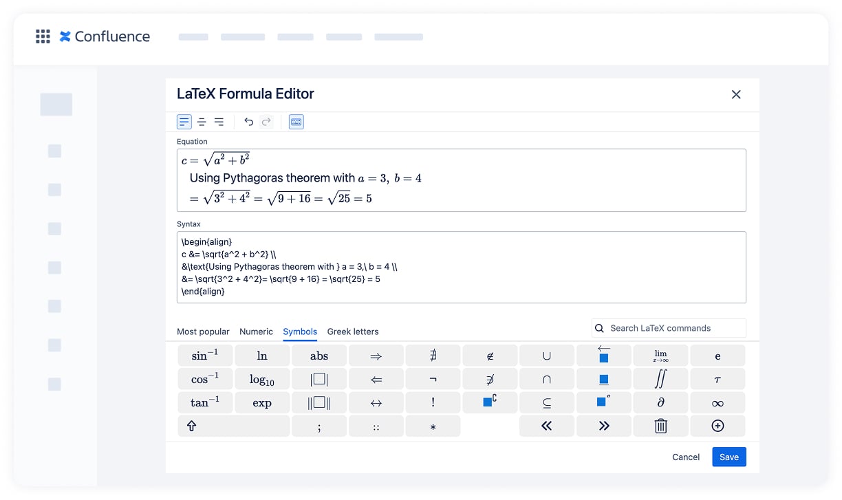

Example 3: Equation with explanatory text
You can add comments or explanations between lines using the \text{} command and & to align them:
\begin{align}
c &= \sqrt{a^2 + b^2} \\
&\text{Using Pythagoras theorem with } a = 3,\ b = 4 \\
&= \sqrt{3^2 + 4^2}= \sqrt{9 + 16} = \sqrt{25} = 5
\end{align}
