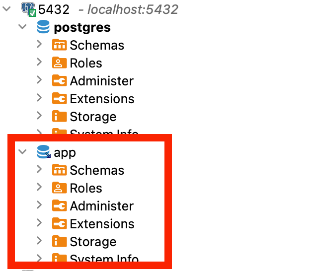

And then I created a database called “app”:

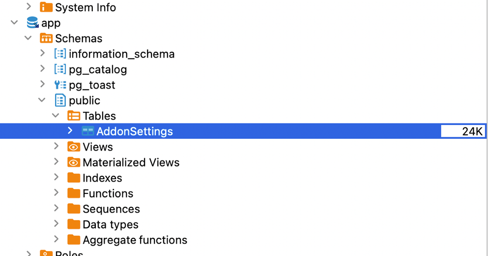

If you look at the app database you will see that a new table called AddonSettings has been created:

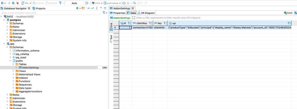

Here is how the table looks after I installed my app:
You can see that we have a new line with the “clientInfo” key. This line was added by atlassian-connect-express and contains information about the client which lets atlassian-connect-express identify and validate requests from the client.
