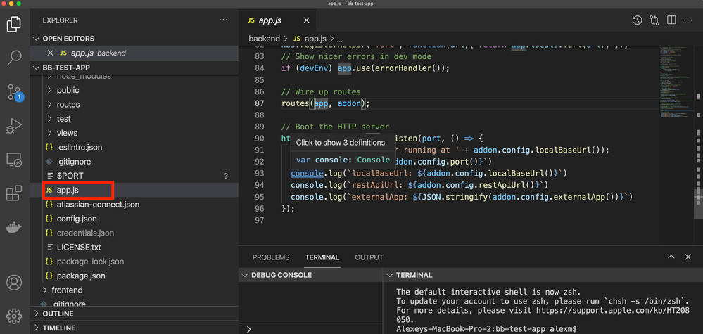

To debug our application in VS code select the backend/app.js file:

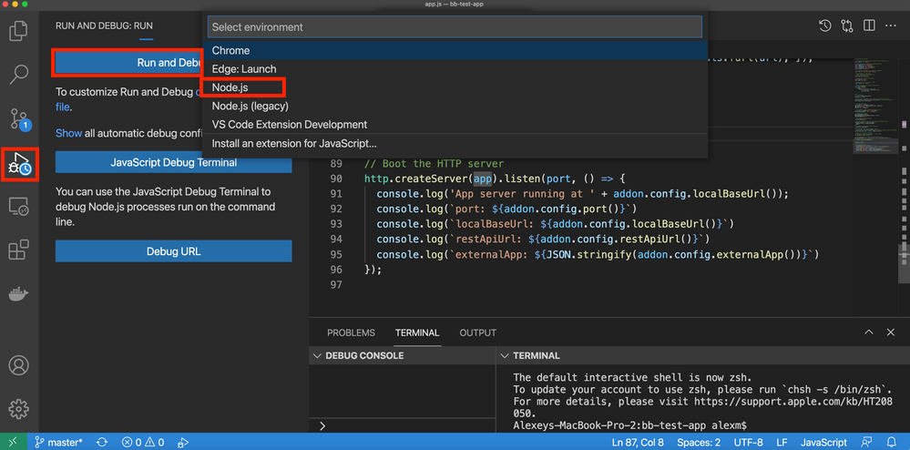

Now open the “RUN AND DEBUG” tab, push the “Run and Debug” button and chose Node.js in the list:

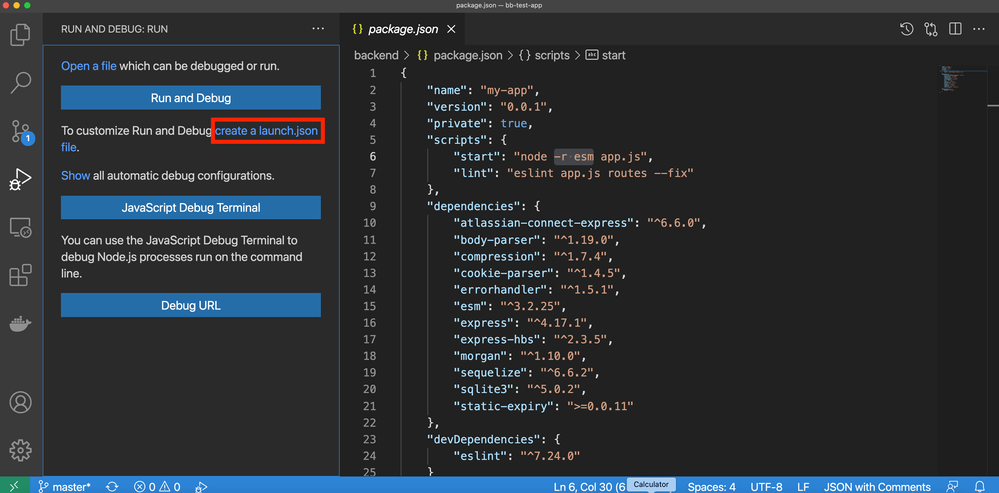

Click on the “create a launch.json file” link (choose Node.js item in the list, which you will see after you clicked the link):
A launch. json file will be created:

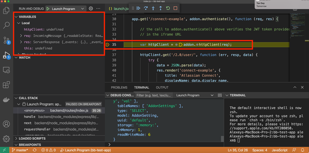

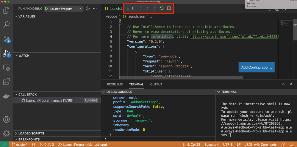

Now let’s push the “Launch Program” button again. Our application is running now:

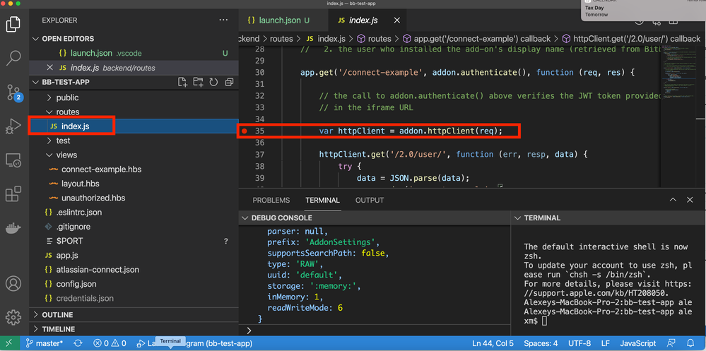

Install our app to Bitbucket and set a breakpoint in the backend/routes/index.js file:

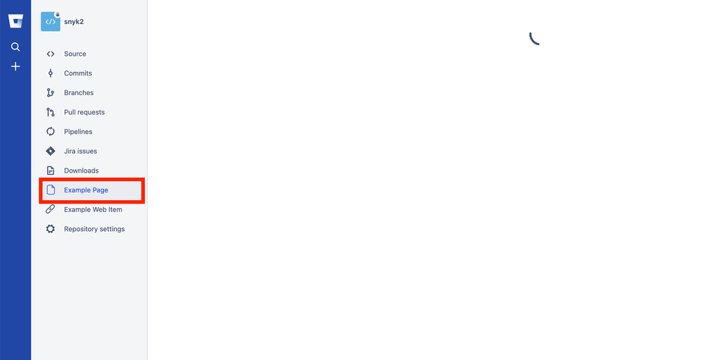

Open the Example Page menu item:
And our app will stop on the breakpoint which we set:
Everything works as expected!
