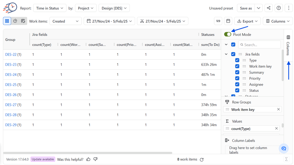

It can be enabled from the Columns panel, with field selection handled in a side panel.
Fields can be dragged into:
  • Row groups — categories to group by, such as Assignee or Project.
  • Column labels — categories to compare side-by-side, such as Status.
  • Values, aggregated as Sum, Min, Max, Count, Average, or Median depending on field type.
The grid updates with every change, so comparisons across dimensions are immediate rather than requiring a new report.

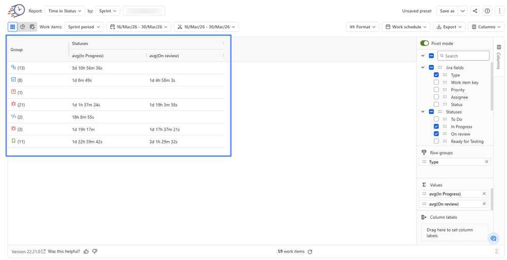

Example 1: Analyze Average Time by Issue Type and Status
Question: Which issue types spend the longest in each workflow status?
Use case: A team groups rows by Issue Type and pivots by Status. This helps compare bugs, stories, tasks, and epics across the workflow.
How to configure:
  1. Set the report scope to by: JQL or Filter.
  2. Open the Time in Status report, switch to Table view, and enable Pivot Mode from the Columns panel.
  3. In the side panel, drag Type into Row groups.
  4. Expand Statuses and drag the statuses you want to compare — e.g. In Progress and On review — into Values.
  5. For each one, set the aggregation to Average
Insight: Bugs may move quickly through development but spend longer in QA. Features may spend more time in review. Tasks may get stuck in waiting statuses.

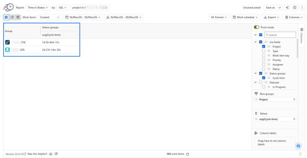

Example 2: Compare Workflow Performance by Project
Question: Which projects have the longest average cycle time?
Use case: A Jira admin groups the report by Project and compares the average or median Cycle Time across projects.
How to configure:
  1. Set the report scope to by: JQL with a query covering multiple projects (e.g. project in (A, B, C)) — this is what puts more than one project into the dataset in the first place.
  2. In Table view, go to Columns → Jira fields and add the Project field, plus Columns → Status Groups and add a Cycle Time group (or confirm one already exists) if it isn't already in the report.
  3. Enable Pivot Mode from the Columns panel.
  4. Drag Project into Row groups. Optional: drag Work item key into Row groups underneath Project if you want to expand a project and see Cycle Time per individual issue, rather than just the project-level average.
  5. Drag Cycle Time into Values, and set the aggregation to Average (or Median).
Insight: One project may carry a longer cycle time simply because more of its work sits in active statuses longer — not because the team is slower, but because the process itself has more steps or handoffs.

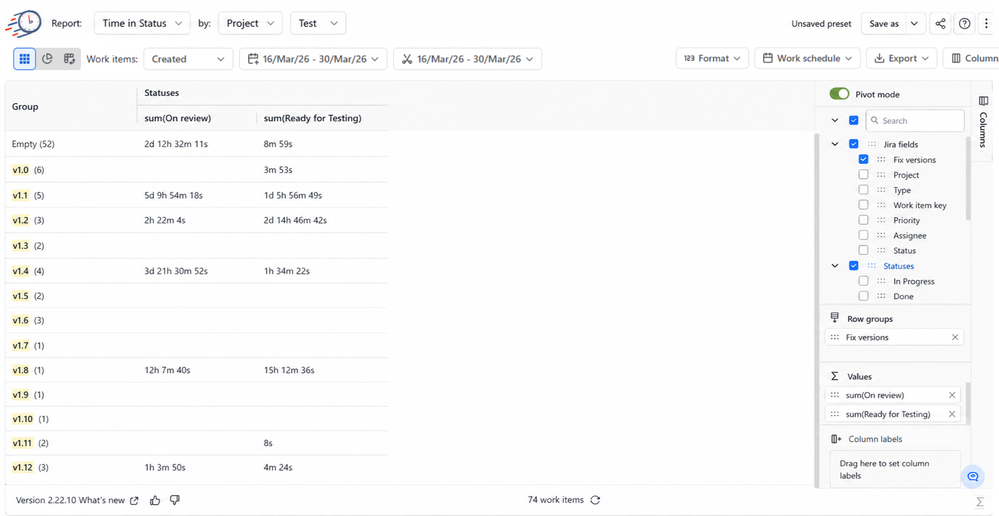

Example 3: Analyze Fix Version Delays
Question:  Which release accumulated the most waiting time?
Use case: A release manager groups by Fix Version and pivots by Status.
How to configure:
  1. Set the report scope to by: Project and select the project whose releases you want to compare (use by: JQL instead if you need Fix Versions spanning multiple projects).
  2. In Table view, go to Columns Jira fields and add Fix versions if it isn't already showing in the report.
  4. Drag Fix versions into Row groups.
  5. Drag the waiting/blocked statuses into Values — e.g. On review, Ready for Testing.
  6. Set each to Sum — this example asks for accumulated time, not an average per issue.
Insight: A delayed release may not be slow because of development. It may be slow because issues spend too much time in QA, approval, or blocked statuses.

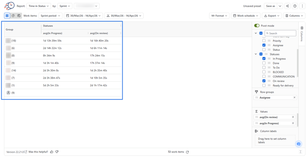

Example 4: Understand Assignee Workload Patterns
Question: Are delays concentrated around specific assignees or roles?
Use Case: A team lead groups by Assignee and compares average time across statuses.
How to configure:
  2. Enable Pivot Mode on the Time in Status report.
  3. Drag Assignee into Row groups.
  4. Drag the relevant statuses (e.g. In Progress, On review) into Values.
  5. Set each to Average.
Insight: One person may appear overloaded because too many issues sit with them in review or testing. This can support better workload balancing.

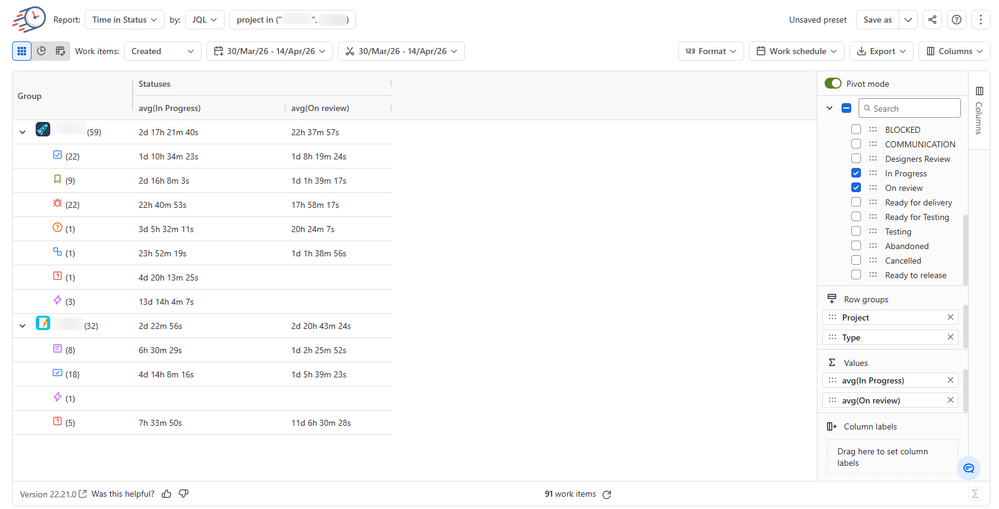

Example 5: Combine Project, Issue Type, and Status
Question: Which type of work causes delays in which project?
Use Case: Enterprise teams combine multiple dimensions to identify patterns that would be invisible in a flat report.
How to configure:
  1. Set the report scope to by: JQL with a query covering the projects you want to compare (e.g. project in (A, B)) — this is what puts multiple projects into the dataset before any grouping happens.
  3. Drag Project into Row groups, then drag Type underneath it in Row groups — this nests issue type inside each project.
  5. Set each to Average (or Sum for total accumulated time per combination).
  6. If you want a further breakdown — e.g. the same view split by Sprint — drag Sprint into Column labels.
Insight: The bottleneck is not simply “QA.” It may be “bugs in Project X during Release Y.”
