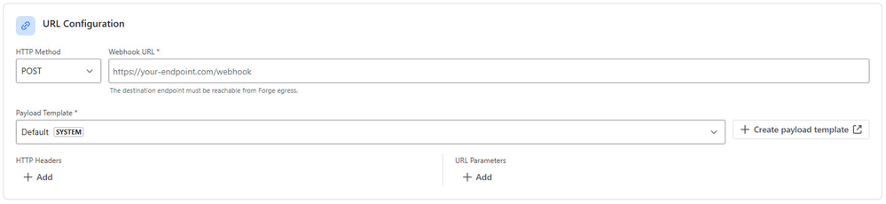

1. You get Jira's payload, not yours
Native webhooks send a Jira-defined JSON body, over POST, to your URL. That's the whole contract. No method choice, no body shaping, no custom headers, no query parameters.
That's fine when you control the receiver. It stops being fine the moment the receiver is something you don't control and that expects its own shape — Slack, Teams, PagerDuty, a partner's API, an internal service with a strict schema.
Choosing the method, the body, the headers and the query parameters per webhook.

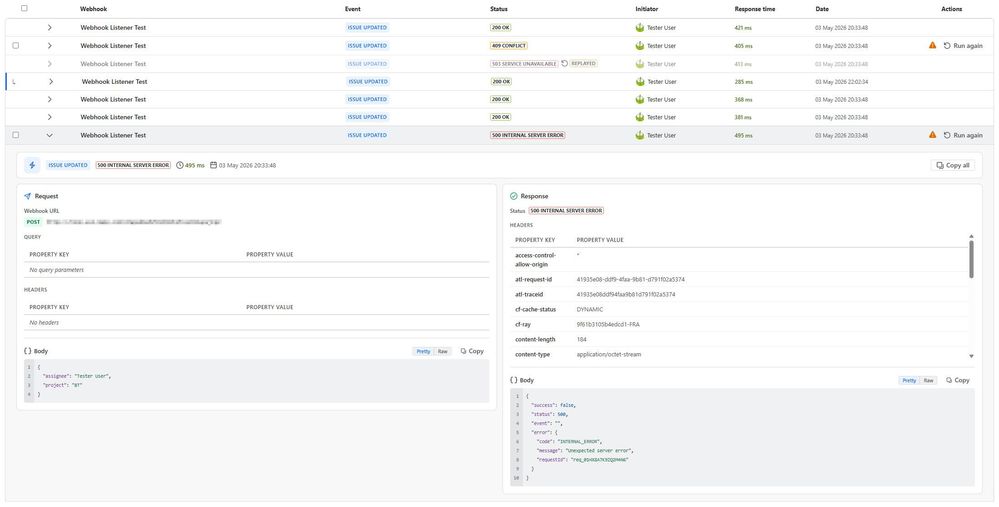

2. Fire and forget: no delivery visibility
This is the big one, and it's the reason most "my webhook isn't working" threads are hard to answer.
Native webhooks give you no delivery log. When something doesn't arrive downstream, you can't tell from the Jira side whether:
  • the event never matched your JQL filter,
  • Jira fired and the receiver returned 500,
  • Jira fired and the receiver returned 200 but silently dropped it,
  • DNS failed, TLS failed, or the request timed out,
  • the receiver was fine and the problem is three hops further downstream.
From inside Jira, all five look identical. So debugging turns into instrumenting the receiver and waiting for the problem to happen again — which, if it's intermittent, can take days.
The same five cases, told apart: a 500 next to a 409 next to a replayed 503, and the receiver's own error body sitting beside the request that caused it.

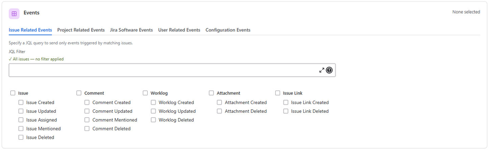

5. Some events simply aren't there
Native coverage is broad but not complete. Eight that come up regularly and don't exist as native webhook events:
  • Issue Assigned
  • Issue Mentioned
  • Comment Mentioned
  • Version Archived
  • Version Unarchived
  • Component Created
  • Component Updated
  • Component Deleted
"Notify the on-call channel when someone is @-mentioned" and "sync our component list to the service catalogue" both sound trivial and both run straight into this.
Issue Assigned, Issue Mentioned and Comment Mentioned as ordinary checkboxes, alongside the JQL filter.

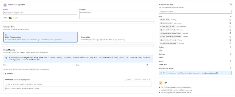

  • Request shaping — choose the HTTP method, and define the body yourself. Either pick fields, or write the exact JSON with {{issue.key}}-style placeholders. Custom headers and URL parameters too.

Two ways to define the body: map Jira fields to keys, or write the JSON yourself.
