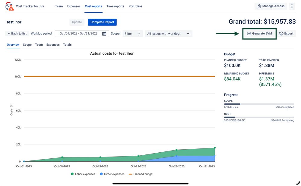

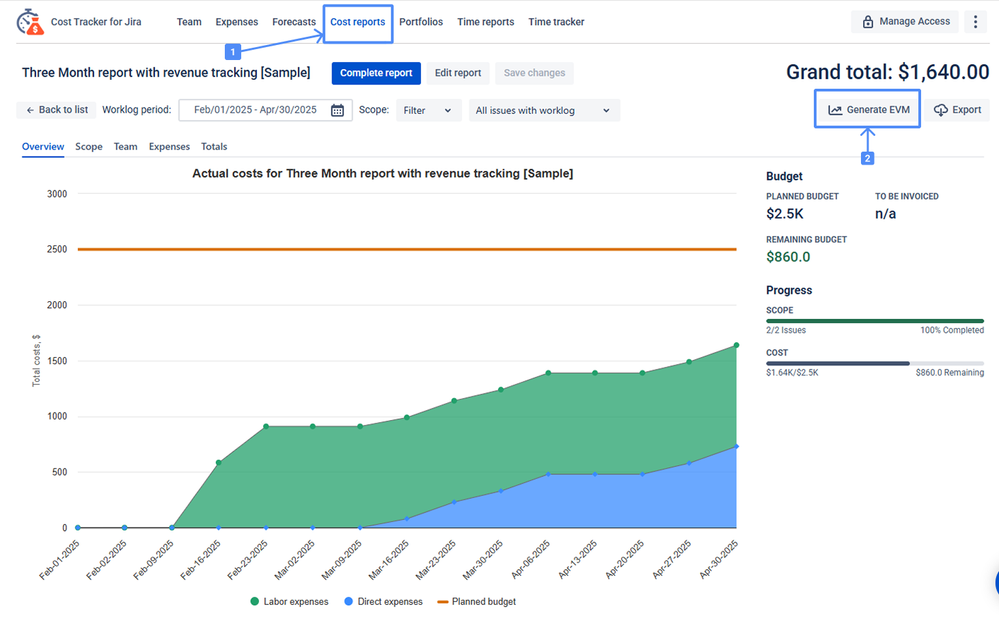

  1. Data Foundation: Meticulously log work hours, expenses, and set accurate team member rates within your Cost Tracker.
  2. Report Generation: Create detailed cost reports with the desired filters (project, date range, etc.).EVM SaaSJet IMG 0577.jpeg

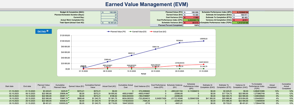

  3. EVM Export: With a single click, export your report into a pre-formatted EVM Excel template.
  4. In-Depth Analysis: Delve into the populated Excel template, revealing critical EVM metrics.Знімок екрана Jan 23 from SaaSJet.png
