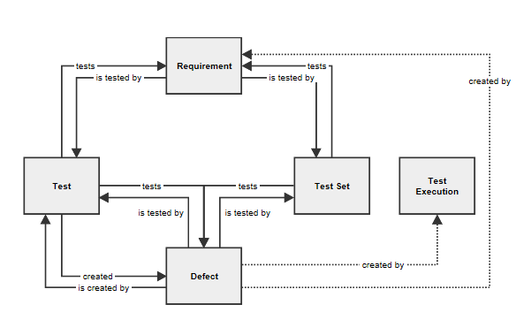

You may associate Requirements and Defect issues with Test case and Test Set issues within the default linking mechanism. The following diagram illustrates this.
