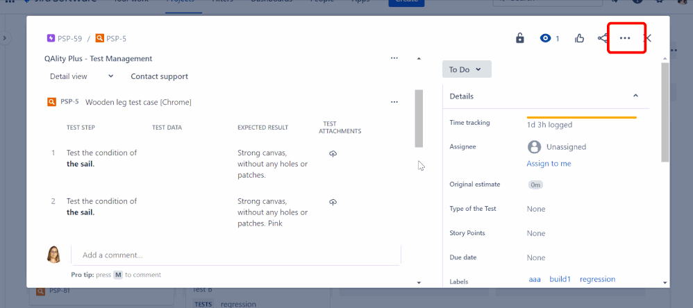

Clone Jira issue (Test Case) to clone it with steps
You might need to create multiple test cases with a very similar test case scenario. For example, imagine you want a distinction between testing environments and you have almost identical test cases – one for Firefox and one for Chrome. You can then clone a particular test case, so you won’t need to rewrite it. When you open a certain issue, there will be three dots in the top right corner. All you need to do is click on them and select Clone. The test case and the steps it contains will then be cloned and saved in the project.

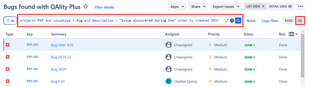

Using JQL filters to see certain issues
You can create a JQL filter with a specific test type so only those will be displayed. For example, you may set a filter to display bugs created during the test case execution.
Head to Filters -> View all filters. In the right corner choose JQL, and type the following command in the search bar:
project= PSP and issuetype = Bug and description ~ "Issue discovered during the" order by created DESC

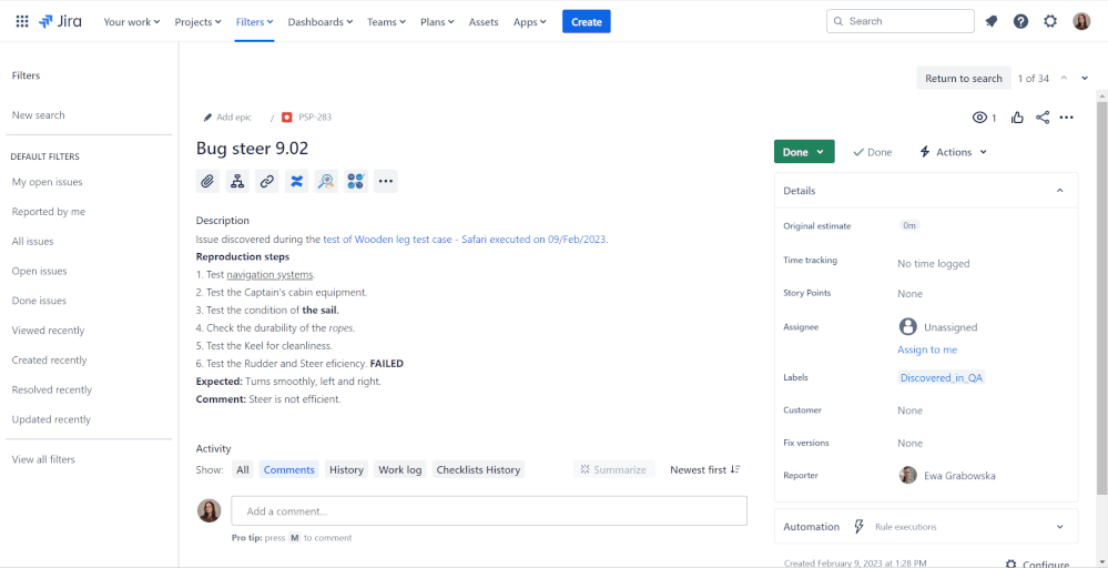

This will show you all PSP project bugs with “Issue discovered during the" in the description. It will be added automatically, so it’s important to not delete it from the bug description.

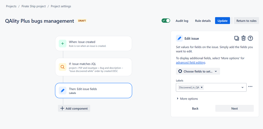

Using automation to add extra labels
You can use Jira automation in QAlity Test issues or Bugs created during test execution. For example, you can automatically add a label to the Bugs created with QAlity Plus.

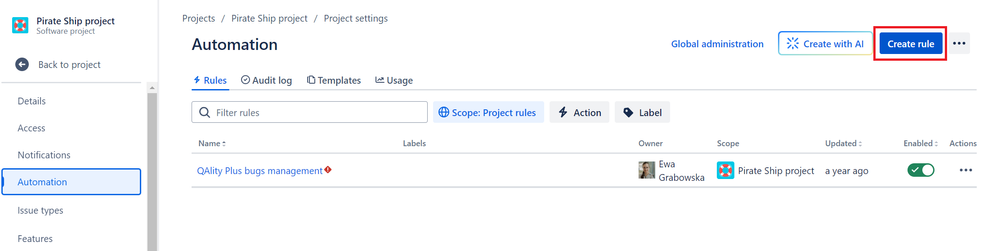

To do that, go to Project settings -> Automation. Once there, click the Create rule button.
To create an automation rule you need to find the right components in the search panel on the right. Build the following scheme:

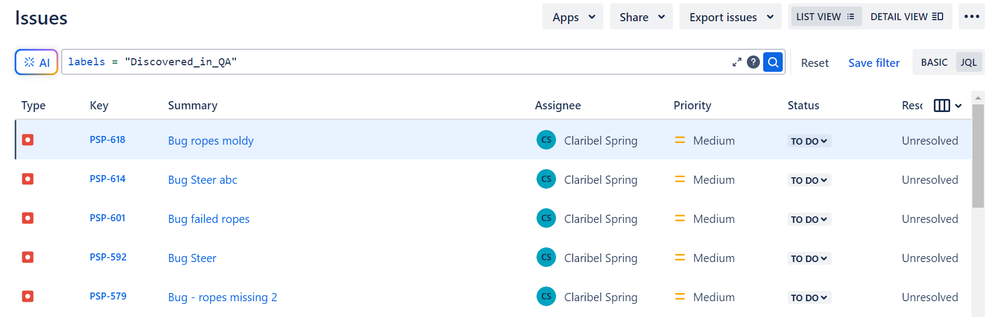

JQL rule you want to use: project= PSP and issuetype = Bug and description ~ "Issue discovered during the" order by created DESC
In our example, we will choose the Edit issue and tick Labels. Then, we will be able to choose a previously created label or create a new one. Let’s create a label called “Discovered_in_QAlity”. On the right, you can type the name and save it.
It will make it easier to organize your bugs. With this kind of label, you will be able to quickly open a link with all these issues, so it will be more convenient to navigate through them.

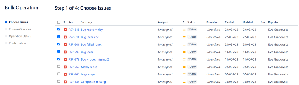

Bulk update test cases
Whenever you need to change multiple issues, you can save time by changing all of them with one operation. Filter your test cases and choose parameters you’re interested in (e.g. an issue type and a certain date range). Then, click on the three dots at the top right corner and choose bulk change.
You can select all or just the ones you’re interested in. Click Next, and you will be able to:
After you perform all the changes click Next and then Confirm on the next page. For example, we’ve decided to bulk change assignee for the selected issues:
The result:

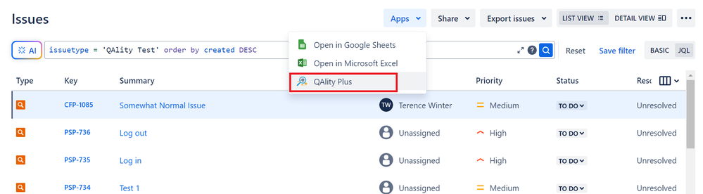

Instead of adding every single test case to the test cycle, you can bulk-add them all at once. In order to do that, open QAlity Plus and go to Filters -> View all filters, and filter the test cases that you want to bulk add to a test cycle.
Next, go to Apps -> QAlity Plus:

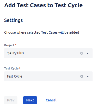

Choose the option +Add all QAlity Test issue(s) to Test Cycle. The app will then ask you where and what issues you want to add.
Please notice that bulk change operations can’t be performed by every user. They require the appropriate project-specific permission and the global Bulk Change permission. These can be granted by your project admin.
