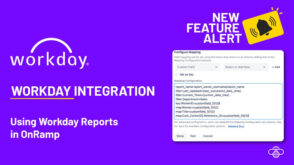

Example field mapping in OnRamp:
report_name:report_owner_username/report_name
filter:Last_Updated={last_successful_date_time}
filter:Department=Sales
key:WorkerID=customfield_10128
map:Worker=customfield_10122
map:Title=customfield_10123
map:Cost_Center[0].Reference_ID=customfield_10010
