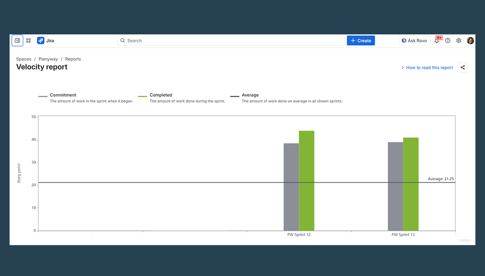

2. The Velocity Chart
Humans are terrible at estimating. We are optimists. We think we can build a spaceship in a weekend.
The Velocity Chart is the antidote to that optimism. It shows exactly how much work your team actually completed in previous sprints compared to what they committed to.
  • How to use it: if your team commits to 50 story points but has a historical velocity of 30, stop them. You are setting them up to fail.

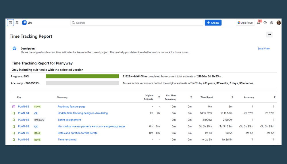

Time Tracking
If you head to the "Forecast & Management" section, you’ll find the native Jira time tracking reports.
These give you a basic rundown of "Original Estimate" vs. "Time Spent." It’s good for a quick pulse check on a specific version release. However, as we mentioned in our Ultimate Guide to Time Tracking, native Jira isn't built for sophisticated billing or deep performance analysis. It captures the data, but it doesn't dress it up nicely for dinner.

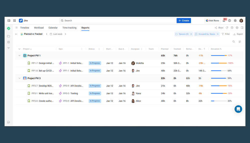

The "Tracked vs. Planned" Solution
If you need to see the gap between expectation and reality, you often need to look outside the box. This is where tools like Planyway shine.
Planyway’s time tracking reports offer a specific "Tracked vs. Planned" view. This goes hand-in-hand with resource management. Instead of just seeing that a ticket took 10 hours, you see that it was scheduled for 5 hours on Tuesday but took 10 hours on Thursday.
It highlights the delta between your plan and your execution, helping you spot which developers are overloading themselves and which estimates were wildly optimistic, then seamlessly update your capacity planner.

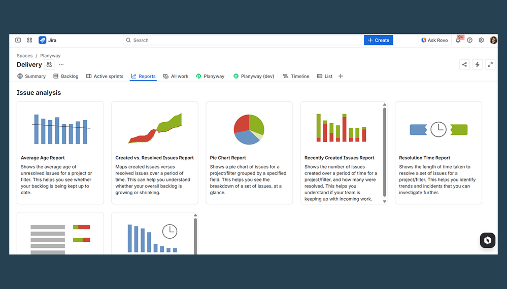

High-Level Statistics
For the broader view of project health, utilize these two native Jira metrics reports:
1. Created vs. Resolved
This is the single most important chart for long-term stability. It compares new issues coming in (Created) vs. issues being closed (Resolved).
  • The Goal: you want the lines to intertwine or for "Resolved" to be higher.
  • The Danger Zone: if the "Created" line is consistently higher than "Resolved," you are accumulating technical debt. You are slowly drowning.
2. Average Age Report
This is the chart that reveals the skeletons in your closet. It shows the average number of days issues have been unresolved.
If this graph is trending upward, it means your backlog is becoming a graveyard where tickets go to die. Use this report to justify a "Cleanup Sprint" to your stakeholders.

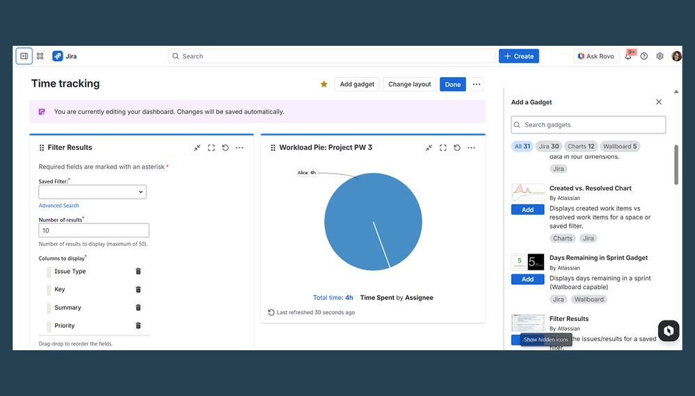

Jira Reports and Dashboards
If you are looking for custom reports in Jira, the Dashboard is your best friend.
A dashboard is essentially a corkboard where you pin different charts (called Gadgets) based on the data you got from your filters.
How to create reports via Dashboards:
  1. Go to Dashboards > Create Dashboard.
  2. Click Add Gadget.
  3. The Pie Chart: Pick your saved filter (from Method A) and break it down by Assignee. Now you have a visual of who is hogging the tickets.
  4. The Two-Dimensional Filter: This is the MVP of Jira custom reports. It allows you to create a matrix (an X and Y axis).
    • Example: Set X-axis to "Assignee" and Y-axis to "Status." Boom. You instantly see exactly what everyone is working on and where it is stuck.
By combining different gadgets, you build a control room tailored specifically to your anxiety levels.

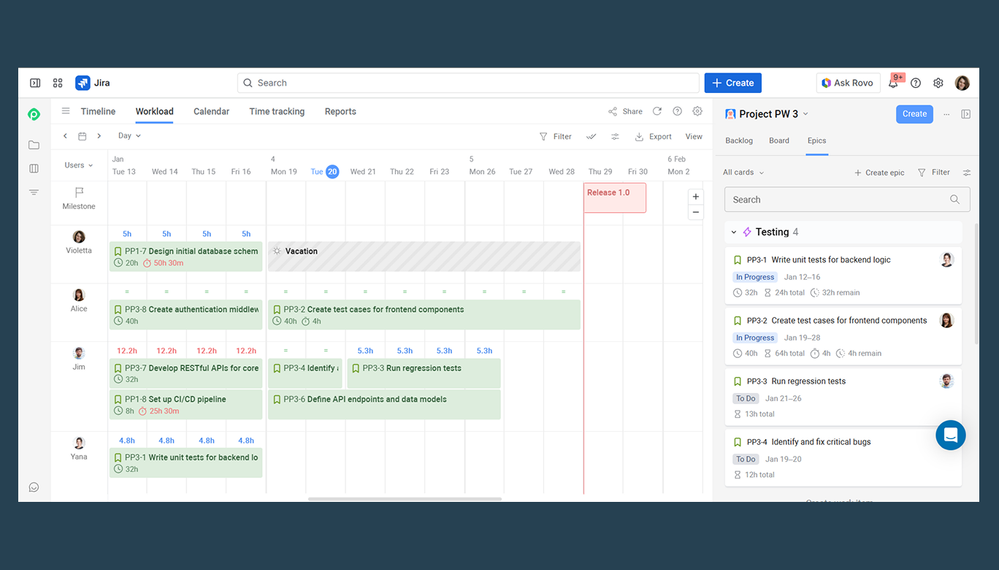

3. Planyway (Roadmap & Capacity Expert)
  1. We mentioned Planyway earlier for time tracking, but it shines in reporting too.
    While EazyBI handles the numbers, Planyway handles the when. It visualizes your data on a sharable roadmap to sync with stakeholders.
If your report needs to answer "Who is working on what?" or "When will this epic actually be delivered?", Planyway’s reporting is the missing link native Jira doesn't provide.
