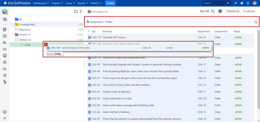

Having built a structure of folders, it’s time to assign tests. Every test repository has two default folders - “All” and “Uncategorized.” The first one contains all the Test Case Templates from the project, and the latter only tests that are not associated with any folder. You can use them to find and organize Test Case Templates, and place them in your folder structure.
Searching for a certain test in a project with a large number of tests might be cumbersome. To make it easier, you can use the JQL search, just like in the Issue Navigator. Select single or multiple Test Case Templates holding CTRL or SHIFT on the keyboard, and place them in folders using drag and drop. If you are familiar with the backlog in Jira Software, working with test repository will be easy, because its functionality is quite similar.

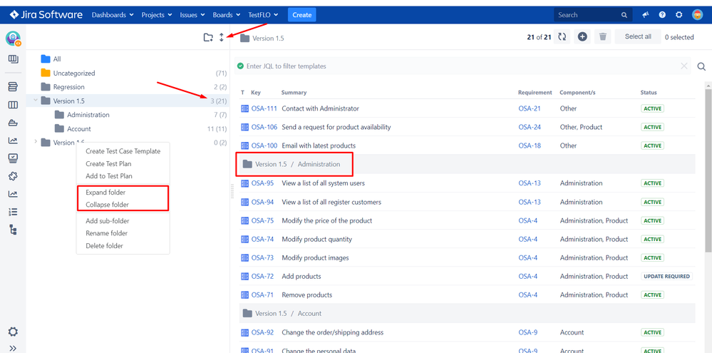

The Test Repository might have a complex structure and users need to have the means to explore it. As multi-level objects, folders can be expanded and collapsed. This action is available for a single folder or it can applied to all folders at the same time. If a parent folder contains any sub-folders, their paths will be shown on the list grouping tests contained in certain folders. These paths are informative and interactive at the same time. Clicking a folder name in a path takes the users directly to this folder.
Another useful piece of information is the number of tests in a folder. For the “Uncategorized” folder, there’s only a single number and it tells us how many tests are still waiting to be categorized. User folders are label with two metrics - the number of tests stored directly in the folder and all the tests, including all sub-folders.

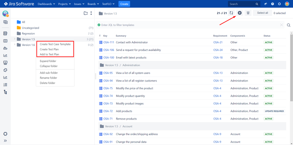

Folders are not only a test categorization tool. They can be used to perform some of the most common operations in TestFLO. These operations are available from the context menu of a folder and include:
  • Create Test Case Template - creates a new test in a folder.
  • Create Test Plan - creates a new Test Plan with Test Cases based on tests contained in the selected folder.
  • Add to Test Plan - adds Test Cases based on tests from a folder to an existing Test Plan.
