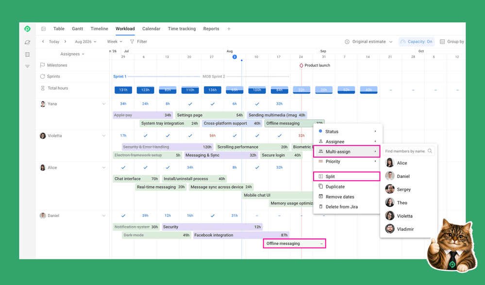

2. Assign multiple people with Planyway
Sometimes you don't want to split a task at all. You simply need to reflect the fact that more than one person is working on it.
This is where Planyway's Multi-assign feature can help.
  • Multi-assign / Split can split a single work item between multiple users.
  • The work item is then shared visually between them.
  • Each assigned piece can have its own estimate.
  • Each piece participates separately in workload calculations.
For example, imagine a task with 20 hours of estimated work. One person might be responsible for 12 hours, while another takes the remaining eight. This makes it possible to keep one Jira issue as the source of truth while reflecting how the work is actually distributed across the team.
This can be particularly useful when:
  • multiple people contribute to the same issue;
  • different people are responsible for different portions of the work;
  • contributors have different workload allocations;
  • team members join the work at different stages;
  • you want to see how shared work affects individual capacity.
Because Planyway combines this with resource planning and workload management, each person's allocation can be considered alongside their other scheduled work. This gives project managers a clearer picture of who is working on what and whether the workload is realistically distributed.
