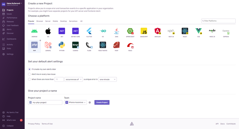

Create Sentry project
After you log in to your Sentry account, in the left menu click on the Projects menu item and Create project.
Choose a platform and a project name (in my case PHP and my-php-project).

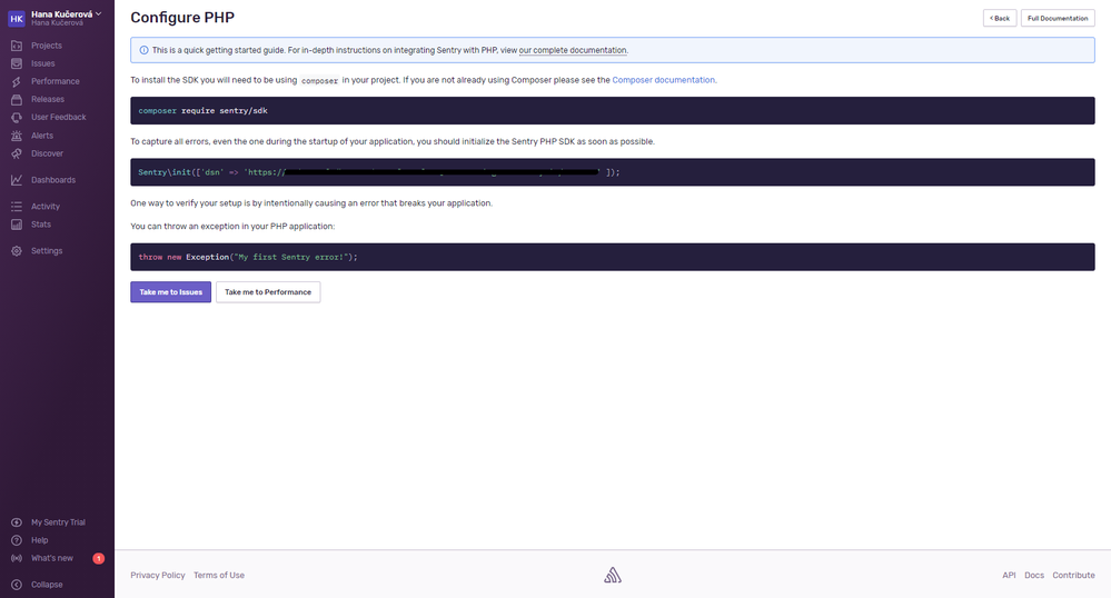

Immediately you are provided with instructions, what needs to be done to capture all the errors in the PHP application.
Create PHP project
I've created sample PHP project with index.php and based on the provided information installed SDK using composer
composer require sentry/sdk

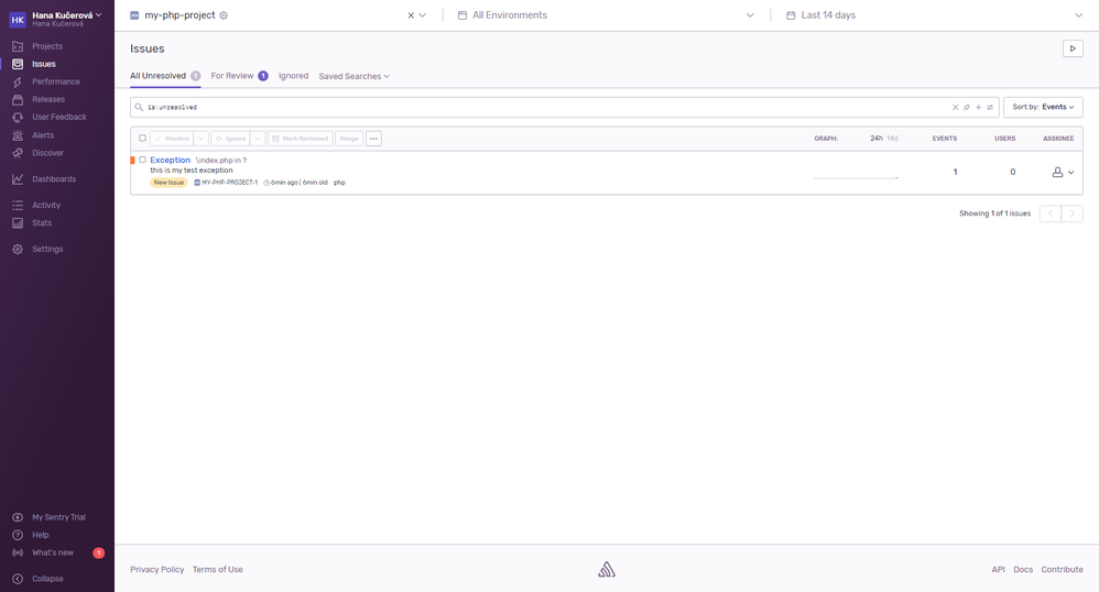

Create the first error in Sentry

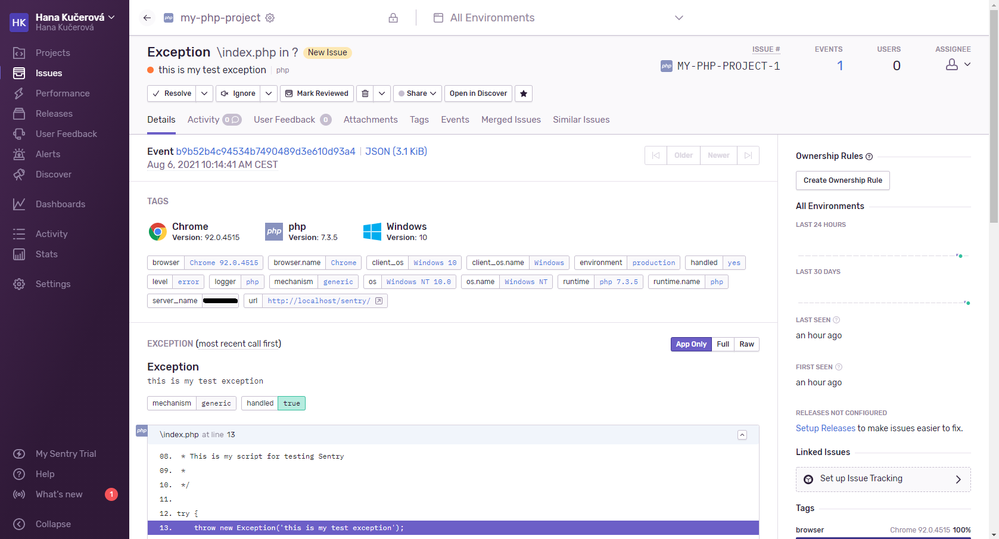

After execution of this code the first error is created in Issues section in Sentry!
You can see a lots of information in the issue detail.

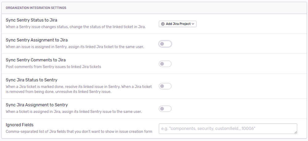

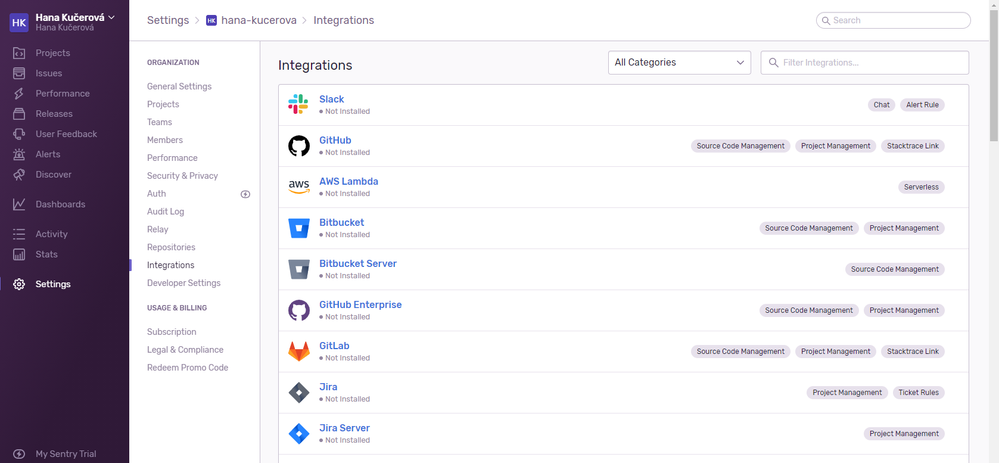

Let's navigate to my organization settings -> Integrations.
Let's select Jira (not Jira Server). Now I'm instructed I need to install integration app to my cloud Jira. After the installation the configuration needs to finished in Sentry.
A lot of things can be configured, I just leave it as it is and go back directly to my Sentry issue.

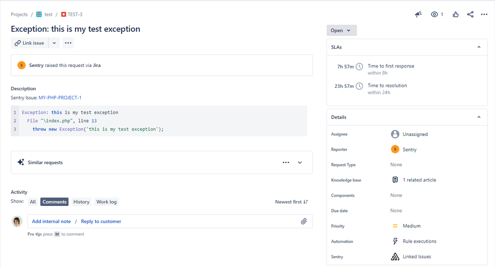

There's a new section in the right panel called Linked Issues in the error detail.

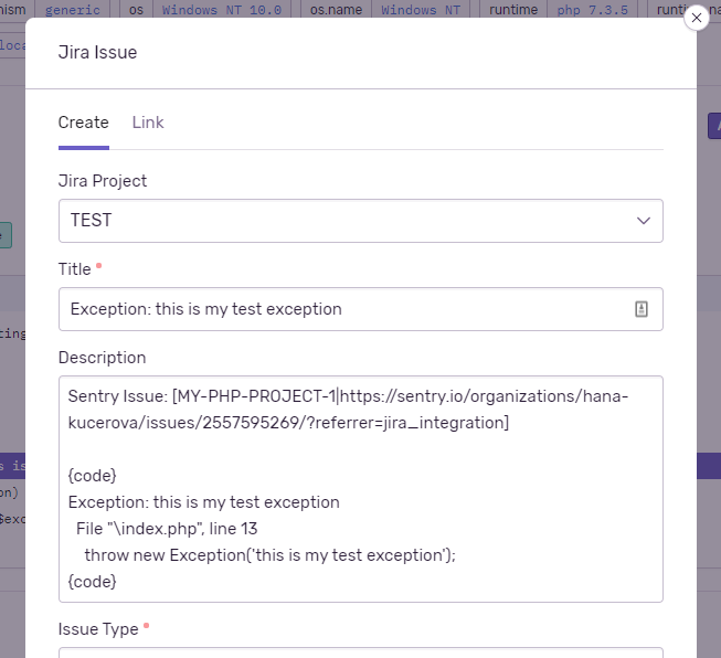

You can either create a new issue in your Jira site or link to the existing one. Let's create a new one.
It is possible to fill in not only the system fields, but also various custom fields. After the issue is created, you can get directly to the Jira clicking on it's key.

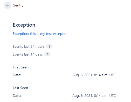

There's Sentry section in the right panel, where you can get additional information and go back directly to the Sentry issue.
