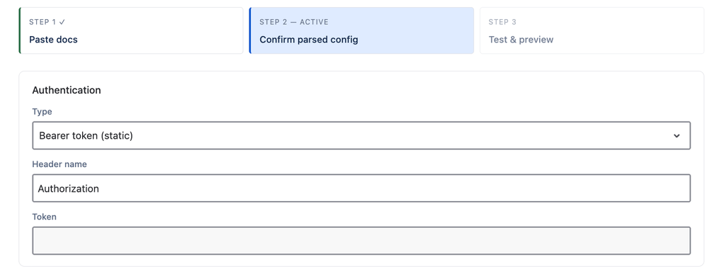

Configuring authentication in OnLink
In OnLink, create the connection with the Bearer Token Static authentication type and paste the Fleet API token.

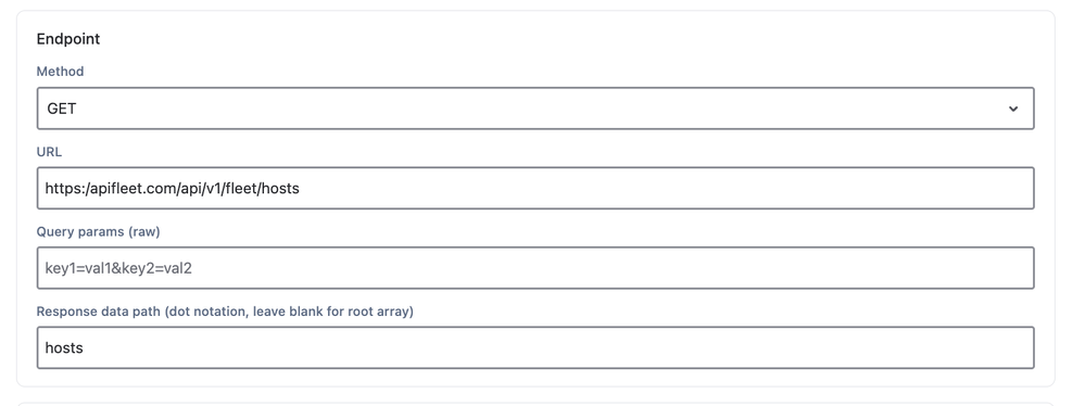

GET methods for hosts
API is GET /api/v1/fleet/hosts.
  1. Set Method to GET.
  2. Set URL to the Fleet API endpoint, for example: Fleet | REST API | Fleet documentation . In the sample below the URL use apifleet.com, please replace with your hostname.
  3. Set Response data path to hosts.
  4. Leave other settings at their defaults unless the endpoint requires query parameters.

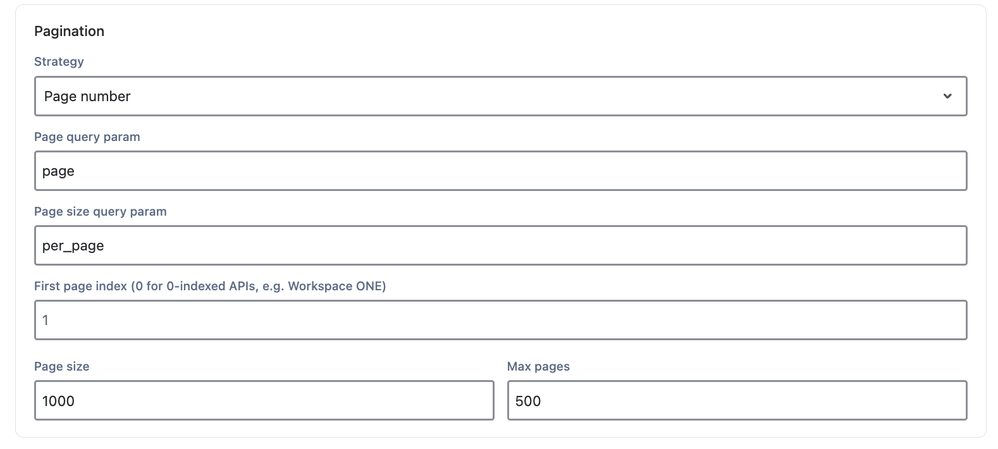

Additional configuration: pagination and filters
Pagination

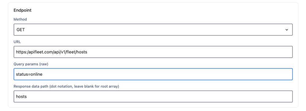

Filters
Use Fleet API query parameters to limit the records returned by the endpoint. For supported filters, refer to the Fleet API documentation for the endpoint you are using.
For supported filters, see the Fleet Fleet | REST API | Fleet documentation.
Example: to filter on hosts that are online, add this query parameter:
status=online
