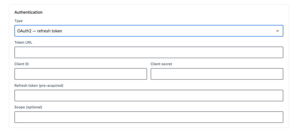

Snowflake Authentication
OnLink supports OAuth authentication to Snowflake.
Snowflake's SQL API accepts three authentication methods — OAuth, key-pair (JWT), and workload identity federation. OnLink uses OAuth, which means you configure an OAuth integration in Snowflake, OnLink obtains a token, and that token rides along on every API request.
Reference: Authenticating to the server — Using OAuth
What Snowflake needs
  1. Set up OAuth in Snowflake. Snowflake supports both Snowflake OAuth (built-in authorization server) and External OAuth (Okta, Entra ID, Ping, and other providers). See Snowflake's Introduction to OAuth for creating the security integration and obtaining a token.
  2. Verify the token works before wiring it into OnLink:
    snow connection test --account <account_identifier> --user <user> --authenticator=oauth --token=<oauth_token>
  3. Send the token on every request. Snowflake expects these headers:
    Authorization: Bearer <oauth_token>
    X-Snowflake-Authorization-Token-Type: OAUTH
    The X-Snowflake-Authorization-Token-Type header is optional — Snowflake will inspect the token and infer the type — but setting it explicitly avoids ambiguity and makes troubleshooting easier.
What to configure in OnLink

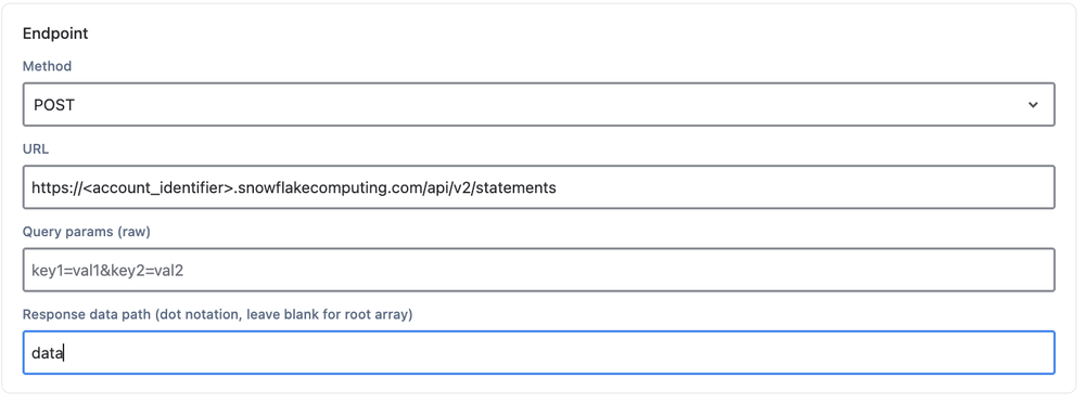

Endpoint Configuration
Executing the Snowflake Query
Once authentication is in place, OnLink submits the query as an HTTP POST to Snowflake's SQL API statements endpoint.
Reference: Submitting a request to execute SQL statements
The endpoint
POST https://<account_identifier>.snowflakecomputing.com/api/v2/statements
Replace <account_identifier> with your Snowflake account identifier — for example, myorg-myaccount.
