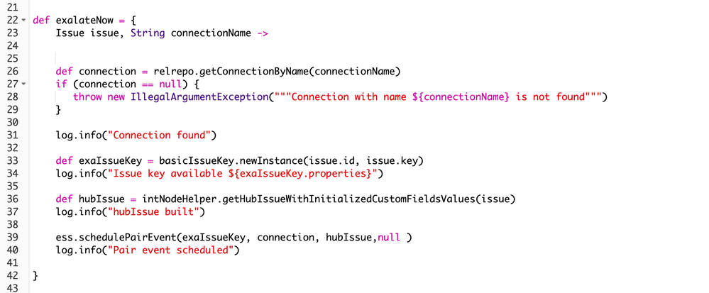

event.issue contains the parent issue which has been exalated.  The exalateNow function is called on every subtask
The exalateNow function is a closure taking an issue object and a connection name.
  • On line 26 - the connection that needs to be used to exalate the subtask is looked up, An error is raised if the name is not found
  • On line 33 - an exalate issue key is generated,
  • On line 36 - the outgoing sync processor is run on the subtask, creating a 'hubIssue' which is the object that will be sent over
  • On line 39, the exalate operation is scheduled (internally it is called Pairing an issue)

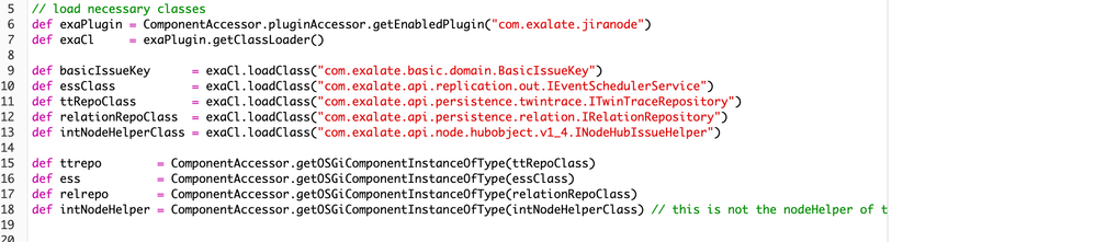

The exalateNow code is using a couple of classes that need to be instantiated.
This can be done using the code below
  • Line 6,7 - get the exalate class loader from the PluginAccessor
  • Line 9 - 13 are used to retrieve the classes from the class loader.
  • Line 9 - BasicIssueKey class is used to generate a unique identifier for the issue
  • Line 10 - EventSchedulerService is the exalate service responsible to manage the sync events.
  • Line 11 - a twin is the couple of issues that are related to each other.  The twin trace repository contains all the twins managed by this exalate. It is not used in the code but it can be useful in certain use cases
  • Line 12 - a relation is another name for connection - the relation repository contains all the defined connections
  • Line 13 - the node helper class is used to run the outgoing sync processor
  • Line 15-18 are used to get access to the OSGiComponents
