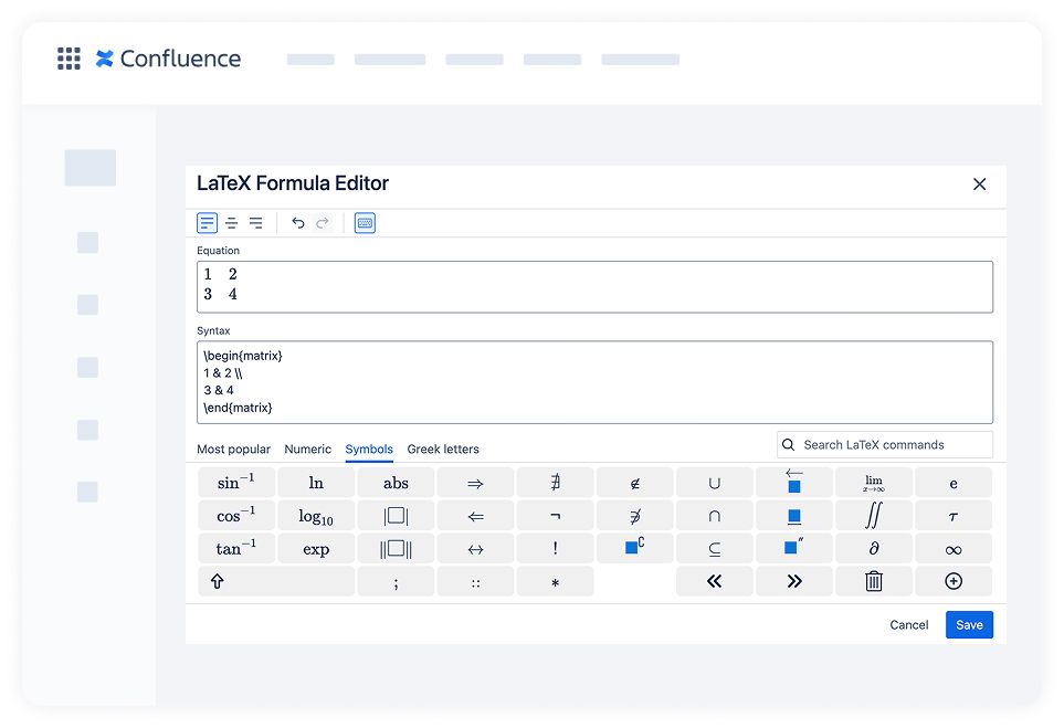

Basic matrix syntax in LaTeX
In LaTeX, a matrix is created inside a special environment that arranges elements into rows and columns. The simplest option is the {matrix} environment:
\begin{matrix}
1 & 2 \\
3 & 4
\end{matrix}
Here's how it works:
  • & separates elements within the same row
  • \\ starts a new row.
This code will produce:

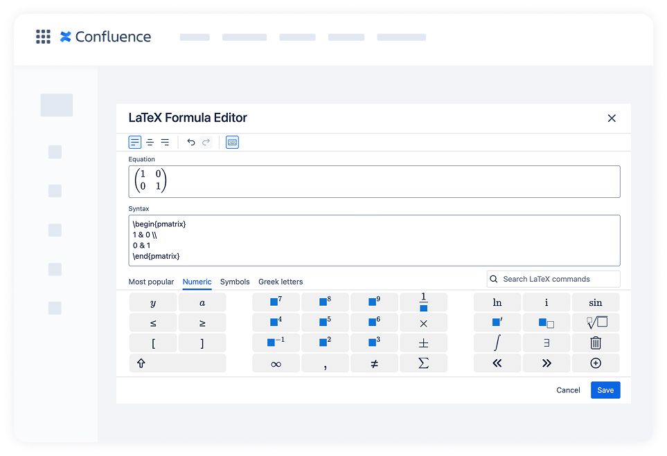

Example: 2x2 matrix with parentheses
\begin{pmatrix}
1 & 0 \\
0 & 1
\end{pmatrix}

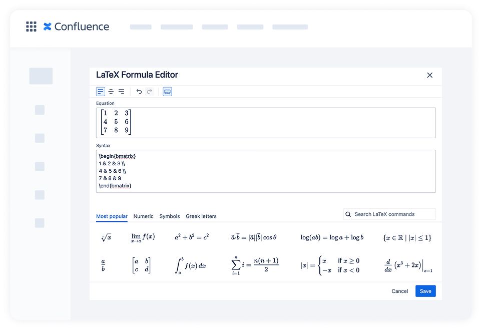

Example: 3x3 matrix with square brackets
\begin{bmatrix}
1 & 2 & 3 \\
4 & 5 & 6 \\
7 & 8 & 9
\end{bmatrix}

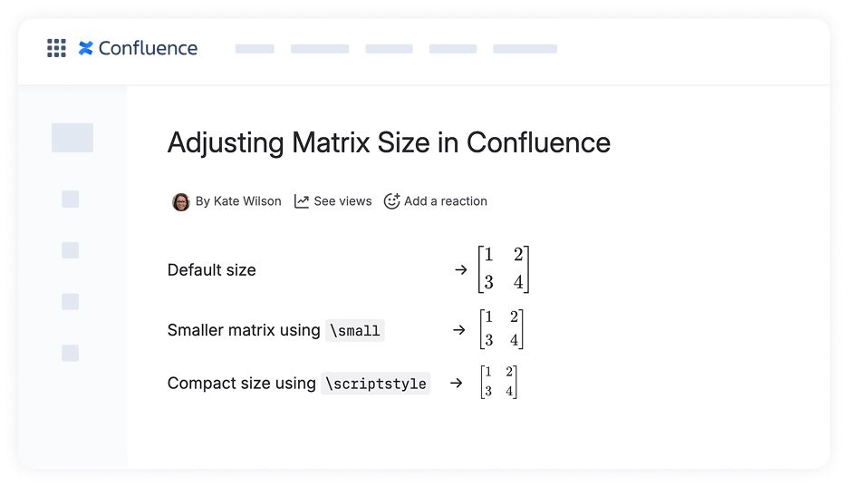

Adjusting matrix size in Confluence
In LaTeX, you can adjust the size of matrices using formatting commands like \small or \scriptstyle. These commands are helpful when you want to fit a formula into a limited space or make a large matrix more readable.
Using the \small LaTeX command
The \small command reduces the overall font size of the matrix. It works well when you want a moderately smaller matrix without making it too tiny.
Example:
\small
\begin{bmatrix}
1 & 2 \\
3 & 4
\end{bmatrix}
Using \scriptstyle for subscript-sized matrices
The \scriptstyle command makes the matrix very compact. It is often used for inline formulas, nested matrices, or when you want to fit a matrix into a tight space. The matrix will appear more "compressed" than with \small.
Example:
\scriptstyle
\begin{bmatrix}
1 & 2 \\
3 & 4
\end{bmatrix}
Here's a visual comparison showing a standard matrix alongside the same matrix reduced with \small and \scriptstyle:
