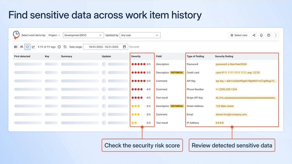

What Is Security Scanner
Security Scanner is a special view within Issue History for Jira app that automatically scans Jira work items and their complete change history for sensitive data.
It doesn’t look at just what exists now. It also analyzes what was there before.
The scanner identifies many types of sensitive data, including:
  • Passwords and passphrases
  • Login credentials
  • Credit card numbers
  • Social Security Numbers
  • AWS access keys and secret keys
  • API keys and OAuth tokens
  • Email addresses and phone numbers
  • IP addresses
  • Usernames and logins
  • Physical addresses and postal codes
Each security finding is classified, so you immediately understand the type of risk you’re dealing with.

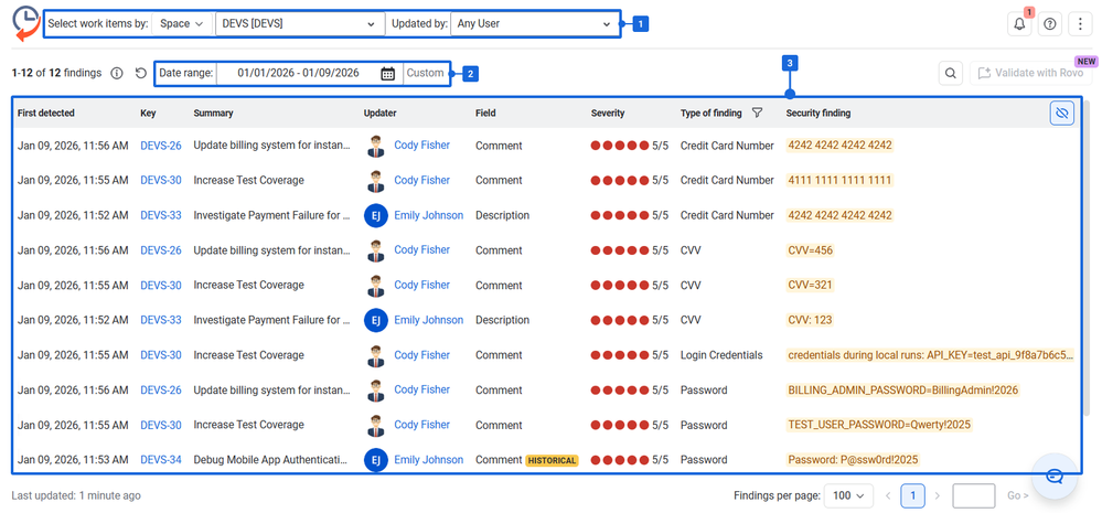

To start searching for sensitive data in Jira work items using Issue History for Jira app, follow these steps:
  • In your Jira, go to Apps, find Issue History by SaaSJet and in its left sidebar menu choose Security Scanner.
  • Select scan filters (e.g., choose the required space or sprint).
  • Set the date range.
  • Run the scan and review the report, which reveals all sensitive data found in your work items (including their history) and their associated risk scores.
The result is a structured table. You can see what matters fast.

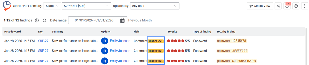

Current vs Historical Security Findings (This Is Critical)
Security Scanner provided by Issue History for Jira app makes clear distinctions between:
🔴 Current Findings: sensitive data still exists in the work item.
🟡 Historical Findings: sensitive information existed in the past, but is no longer visible (for example, in earlier versions of comment or description, and was later removed or updated).
This matters because:
  • Auditors are concerned about historical exposure.
  • Data that has been removed can still be recovered.
  • Past leaks might still need mitigation.
  • Most tools completely ignore this.

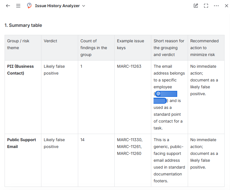

Analyze Security Scanner Findings with Rovo
Reviewing dozens, or even hundreds, of detected sensitive data findings can take time. To speed up investigations, Issue History for Jira now lets you analyze Security Scanner findings with Atlassian Rovo.
Instead of manually reviewing each finding, Rovo generates an AI-powered summary that helps you quickly understand:
  • the type of sensitive data detected
  • why the detected data may pose a security risk
  • recommended remediation steps
  • which findings require immediate attention
