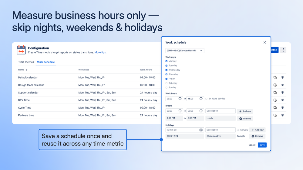

Step 1 — Create a work schedule
Open the app from your Jira sidebar. From the report screen, click the three dots (⋯) in the top-right corner → Configuration, then select Work Schedule.
This is where you tell the app what "working hours" actually mean for your team:
  • Time zone: Evaluates metrics against your team's local time, not the global Jira server default.
  • Work days: Select active working days (e.g., Monday–Friday).
  • Work hours: Set team shift times (e.g., 09:00–17:00), or toggle 24/7 coverage for round-the-clock ops.
  • Breaks: Exclude lunch breaks or handoff windows so they don't count toward active time.
  • Holidays: Add regional or company holidays, complete with an Annually toggle so recurring dates roll over automatically.

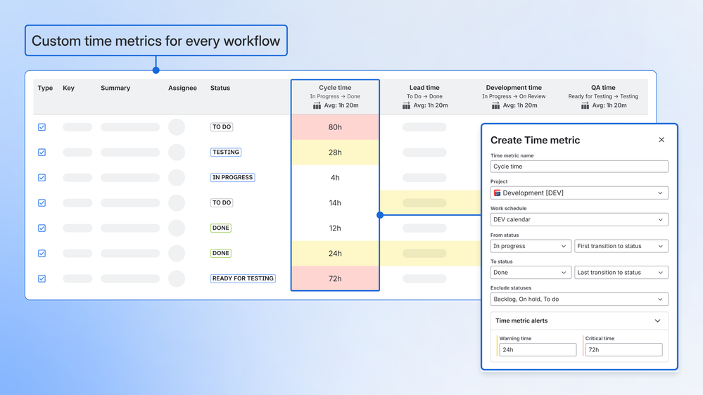

Step 2 — Define metrics for any status pair
Back in Configuration, click Time Metrics to add a new rule. You aren't limited to generic Cycle or Lead Time — you can measure any stage in your workflow: code review duration, QA turnarounds, approval wait times, or initial response speed.
For each metric, configure:
  • Time metric name: A clear label (e.g., Resolution Time or Code Review Duration).
  • Project: The Jira project this metric applies to.
  • Work schedule: Select the schedule created in Step 1 so the clock runs only during active hours.
  • From status → To status: Set your start and stop triggers (you can also require specific transitions if needed).
  • Exclude statuses (optional): Pause the clock when tickets sit in designated idle statuses (e.g., exclude Waiting for Customer so your Resolution Time reflects pure team effort).
  • Warning & Critical limits (optional): Set thresholds to flag stalled issues automatically before they derail a sprint.

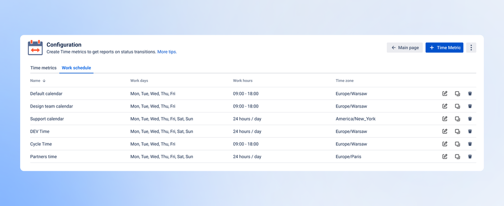

Step 3 — Reuse schedules across teams
Schedules are modular. Create a calendar once, name it, and link it across multiple metrics. Because each schedule holds its own timezone, working hours, and holidays, cross-functional teams can work side-by-side without skewing each other's metrics.
Example: A New York Design team, a 24/7 Support crew, and an engineering team in Europe can each run on tailored calendars. Set up Cycle Time for Dev and Resolution Time for Support, attach their respective calendars, and your metrics remain fair internally and honest across teams.
