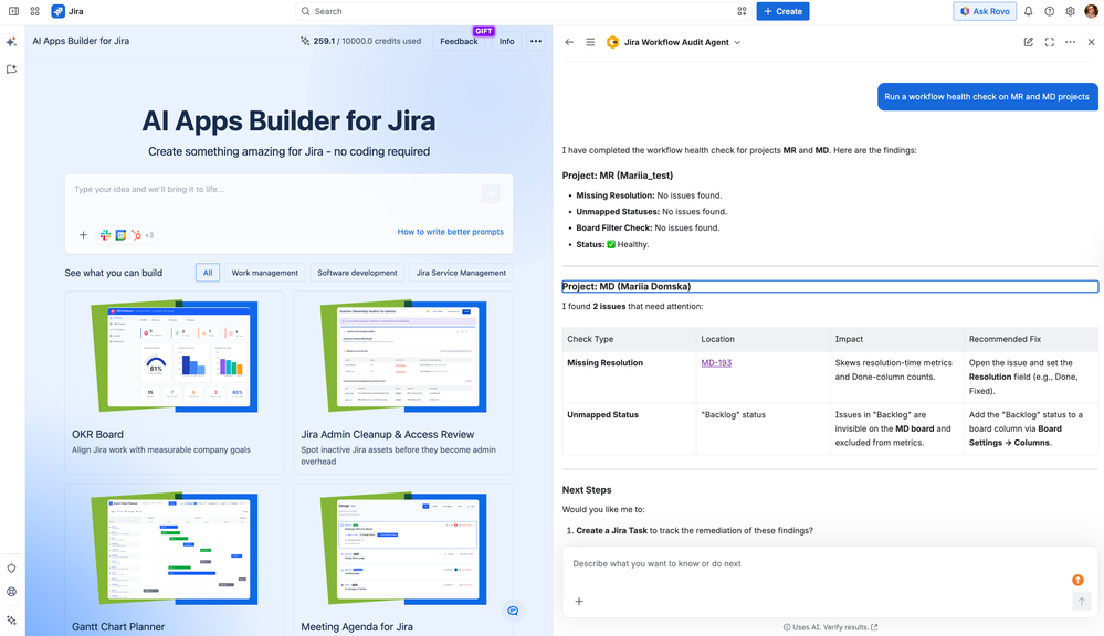

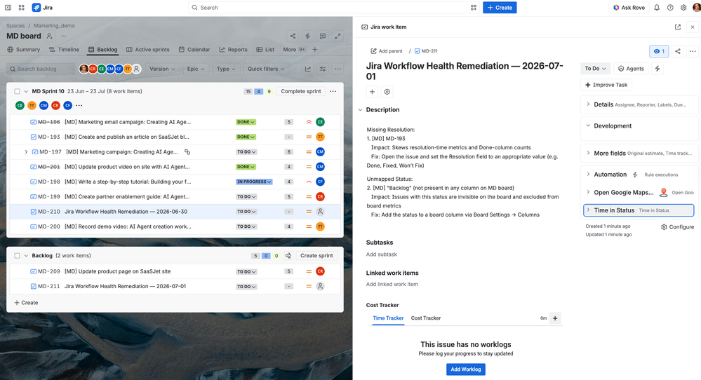

  1. A Jira task with the findings. If the audit finds at least one problem, the agent creates a task in the admin or ops project you specify, with a numbered breakdown grouped by check type: location, impact, and recommended fix for each finding. If nothing is found, no task gets created, and the agent tells you directly.
What Happened When I Ran My AI Agent
When I ran my Jira Workflow Audit Agent against two real projects, I got two reports:
  1. The project has a Healthy status.
  2. The project has 2 issues that need attention.
Jira admins usually don't know a workflow is misconfigured until reports start showing numbers that don't add up. Finding these problems by hand is slow and easy to miss. Having an agent run the check on demand saves real time. Even a simple agent that checks for three specific problems does more than most people check manually.
Plus, I asked my AI Agent to create a Jira Task to track the remediation of these findings, and it did.
