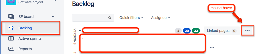

Hover works on the three dots icon of the dashboard/backlog view. Hover over the icon and see the sprintID in the URL view at the bottom of the browser. Works for both future sprints and active sprints.

Going to Backlog view and hover over the Three Dots
As simply as that... Congratulations, @Edison Quisiguina.
Thanks. You can see the id in the botton of the page.
