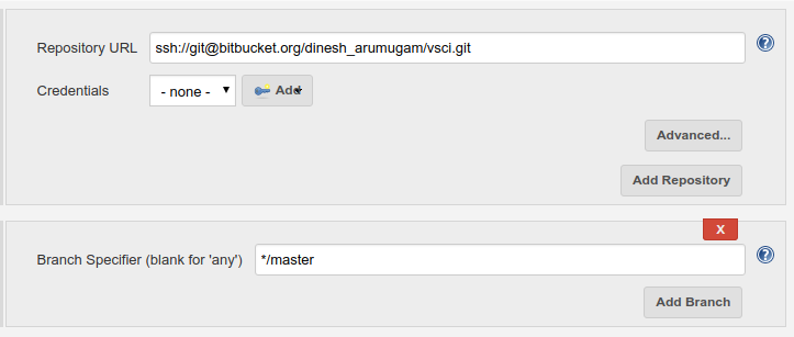

dinesh_arumugam
July 17, 2018
Hi Claudio,
when connecting to Bitbucket from jenkins repo
the actual url given by bit bucket is "ssh://git@bitbucket.org:dinesh_arumugam/vsci.git"
the above url will give the beow error:
Failed to connect to repository : Command "git ls-remote -h ssh://git@bitbucket.org:your_name/vsci.git HEAD" returned status code 128:
stdout:
stderr: ssh: Could not resolve hostname bitbucket.org:dinesh_arumugam: Name or service not known
fatal: Could not read from remote repository.
Please make sure you have the correct access rights
and the repository exists.
To solve the above error just change the bitbucket repo link to
ssh://git@bitbucket.org/your_name/vsci.git
by just replacing the ':' in to slash '/' before your name
to configure it in jenkins jobs in the GIT repo option.
then try to run the run the below command in your terminal
"git ls-remote -h ssh://git@bitbucket.org/your_name/vsci.git HEAD"
just replace the ':' into a slash '/'
once the command is run you will get it working in the jenkins tool
and your ssh will be generated.
regards,
Dinesh Arumugam
