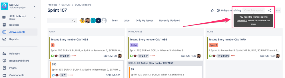

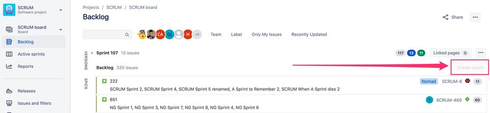

As a SCRUM Master, one of your key tasks involves planning Sprints in your team and in order to do this, you must be able to create new Sprints and complete active ones.
In order to fulfil these tasks as a SCRUM Master, you require the Manage Sprints permission which is configured on a Project level in its Permission Scheme. This permission is required on ALL Projects included on the Board in order to manage the Sprint otherwise you will be restricted from doing so.
When working with complex filters, the Project scope where the Manage Sprints permission is needed can be expanded exponentially depending on the complexity of the filter and the number of Projects susceptible to fall within the scope of the JQL search.
By not being careful with this, this can sometimes lead to the SCRUM Master being blocked from managing a Sprint despite already having the Manage Sprints permission with the options being greyed out.
