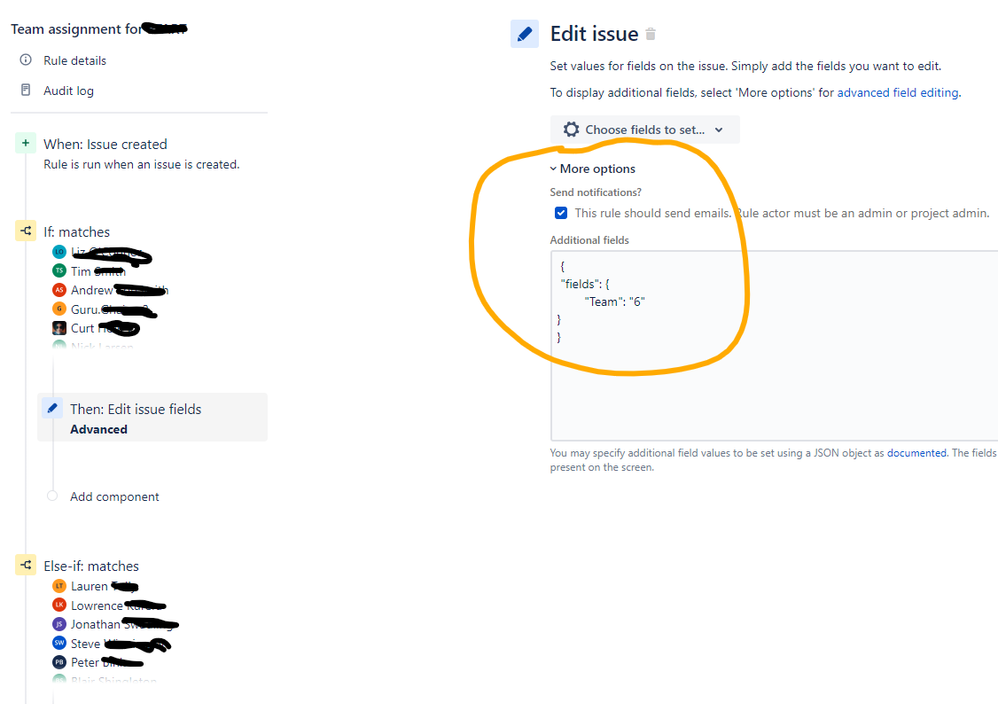

Curt Holley
May 25, 2021
Sure @Daniel Engzell
Trigger = Issue Created
Condition is; User Condition (where Reporter = the team members)
Action = Edit issue (editing the team field)
Note: Use the If/Else condition if you want the one rule to handle more than one team (as below)

How will the automation rule work if an individual (say business analyst or product owner) is in more than one team and then creates an issue?
Curt Holley
June 8, 2021
Good question @Alan Tragarz
The automation only pertains to one project, so if they are working across lots of projects, they could choose if they should be configured in the automation rule or not.
If they are working with.creating content for lots of teams within the one Jira project, i would recommend they are not configured for the automation and would continue to manually add the relevant team to any content they create (based on the nature of their role).

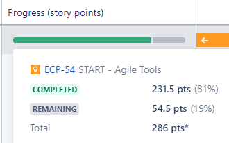

Can a roadmap show Epics with their related issue types along with % completion of the specific epic? Also can the roadmap show not only To Do or In Progress but Done items as well?
Curt Holley
June 8, 2021
HI @Alan Tragarz
Yes, there are two fields you can select, "Progress (Story Points)" & "Progress (Issue count). both of these will show a % completion rate (of an Epic's Stories amalgamated points) See Initiative below (with points from Stories 2 layers down the Hierarchy)

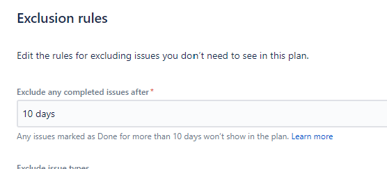

Yes, you can decide how long you show "Done" content on your plan. Go to:
Configuration/Exclusion Rules and set the length of time you'd like "done" issues to remain on the plan.

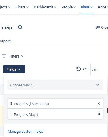

Alan Tragarz
June 8, 2021
Thanks Curt. I'm on the Jira Cloud version so not sure if that has any difference. I ask because I see different Progress fields (e.g. not story points). Also might be the wring Roadmap (Plan > Roadmap vs Project > Roadmap)?
Curt Holley
June 8, 2021
Hi @Alan Tragarz Sorry, i was talking Cloud.
OK, I think the reason you can't see the Story points option is due to the Plan not being configured for Story Points in the Estimation section.
Also, might be worth checking that the Teams in the plan are set up as Scrum teams and not Kanban (as Kanban assumes no story points.....rightly or wrongly)

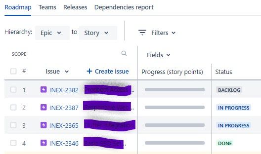

Alan Tragarz
June 8, 2021
Thanks Curt, that got me closer. Now I use Epics and link stories, bugs and spikes to said Epic. I bring in all the Epics I want in the roadmap but the ProgressScreenshot 2021-06-08 143758.jpg doesnt display anything. Could it be that the filter I used is only for Epics?
Curt Holley
June 8, 2021
That is definitely it @Alan Tragarz You need to filter in all of the hierarchy, so that the children are part of the plan, then it be able to do its tricks :-)
