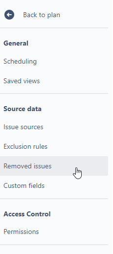

You have to go into the settings and find the removed issues list, then find the epic you need and re-add it.

You have to specifically go into the one I have highlighted, Removed issues. it's in that list if you previously had it in the plan.  Adding it as another issue source will not fix the problem you have described.

Ah, you probably don't have the right permissions then (unless you're on a Server version of Jira, in which case I am not sure).
You'll need an admin for that board to grant you the additional permissions - that's found in "Products" settings for jira, not specifically in Advanced Roadmaps.
