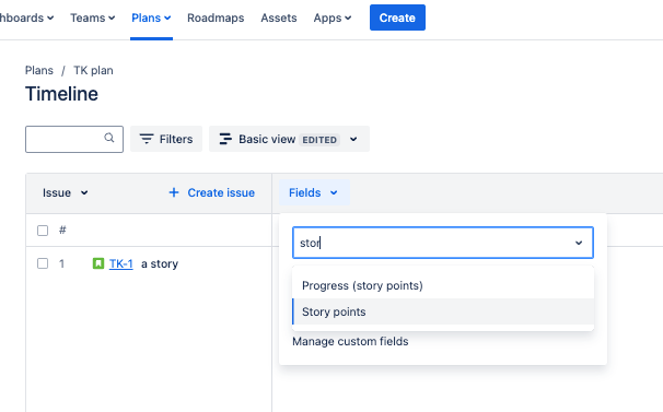

Björn Gullander Eficode
October 22, 2024
Hi, "Story point" field should be found in the Field list per default when the Plan's estimation method is set to Story points.

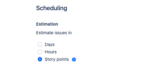

Configuration of plan:
October 25, 2024
Hi, you should not try to add it as a custom field as it is already in the plan by default. Just click on the Fields selector and it should be there.

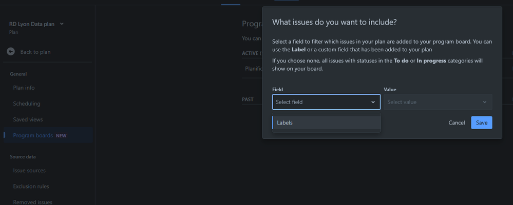

@Björn Gullander Eficode  where can you find this menu to setup your  fields ?
Can't find it on any menu of the plan's settings
Here i got my plan settings, wich seems to be good (but no "fields menu" available)
And in the "Program" menu, i can find a "Field" settings, but nothing to specify witchi story field it should check

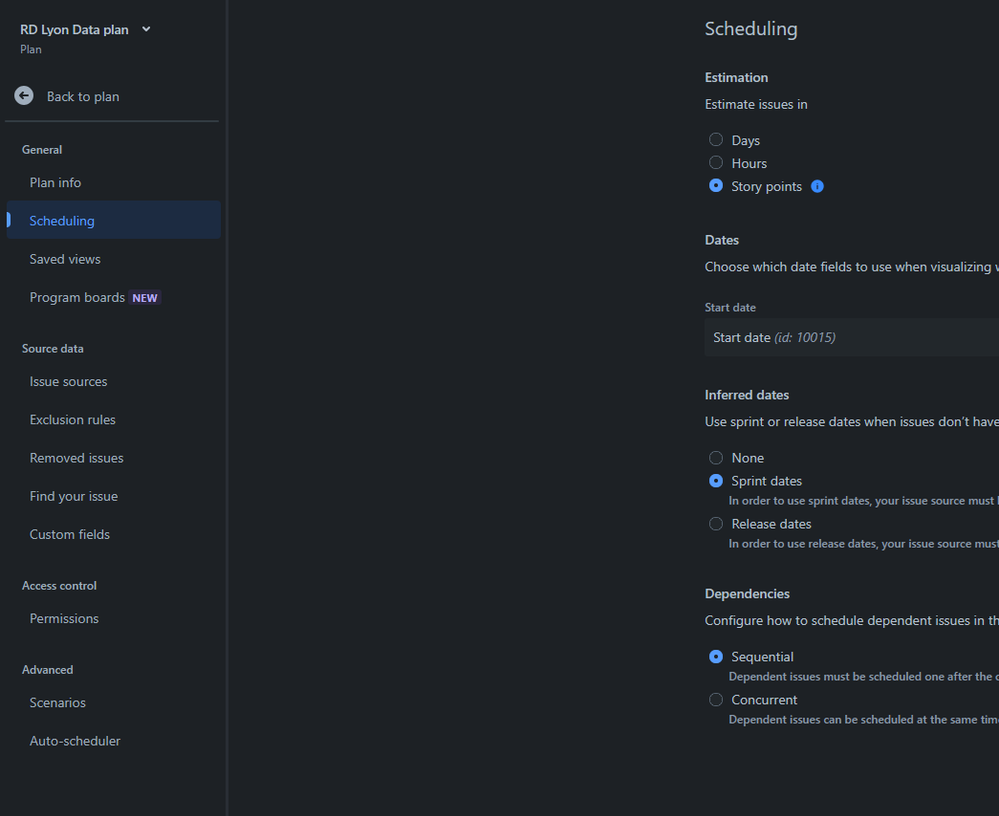

Quentin Sixt
March 19, 2025
Edit: i got this menu ... but can't add any "Story point" field, whether it's estimate, or standard one ...
Just the label.
Marc -Devoteam-
March 19, 2025
Hi @quentin.sixt
You need to select the option Scheduling
Quentin Sixt
March 19, 2025
Thanks for your answer @Marc -Devoteam- , but, where is this option ? In which menu ?
Bescause, as my first screen shows, I already choose the "story point" option, in the "scheduling menu", is there another ?
Marc -Devoteam-
March 20, 2025
Hi @quentin.sixt
In your last screenshot, I see the Scheduling option in the left menu.
This is the option to use.

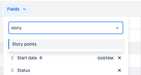

March 20, 2025
Hi  @quentin.sixt
When you have configured your plan to use Story points for scheduling (which i can see you have), you should be able to select the field in the timeline view without anymore configurations.

Quentin Sixt
March 21, 2025
Ok, found my problem.
For someone eventually passing by, it was the "context" option.
Some administrator of our platform had disabled the "Story point" field for all project, except his own one ... so, that's why, even if i could display the field, i couldn't use it.
