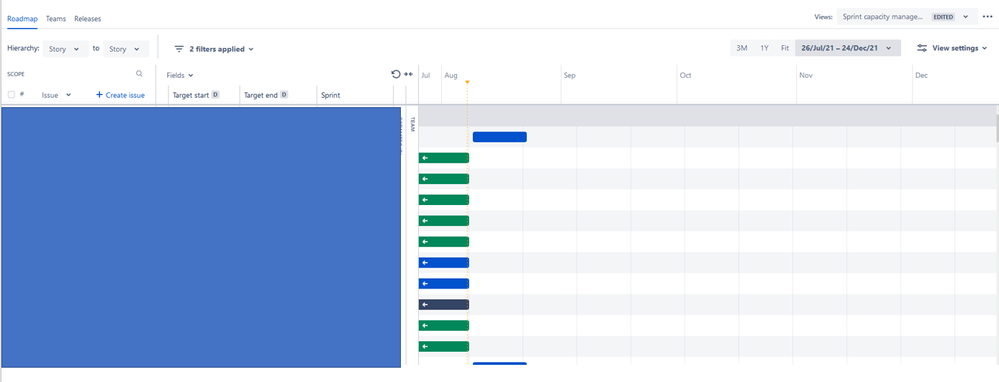

Hi there,
I am trying to get a view of each sprint and its capacity bar based on the allocated stories/tasks in the Advance Roadmaps. I cannot seem to figure out how to bring the view that all the articles of Jira has. I am using the plan to display issues from the project and a Scrum board. We use only 1 scrum board for an active sprint. So not sure if I am doing anything wrong. Please see attached screenshot and advise how to bring the capacity view for each active and future sprints on a plan.

Hi @Shefali Gautam
have a read of this post, it should provide the answer.
Solved: View Sprints on Advanced Roadmaps (atlassian.com)

Thank you, that worked for me. I had to setup my issue source of the Teams as the Scrum board.
