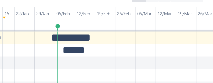

I found out, the "End Date" or "Due Date" can be set by auto-scheduling in Advanced Roadmaps (it depends which field you are using) and it is indeed referring to the estimations.
For marking an expected end date you could insert a "Release", this signalizes the date by a green line then, like so:
Probably this article is also helpful:
