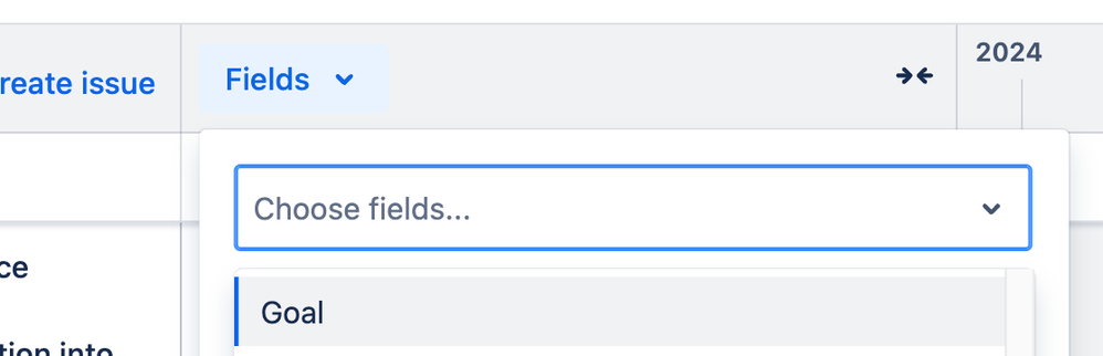

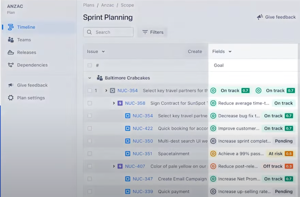

@Nerissa You cannot embed a Plan view currently in an Atlas goal. However, you can view goals and even group work by them in Plans.
Go to Fields and add 'Goal'

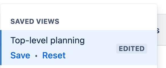

Then make sure you save the updated view. Example

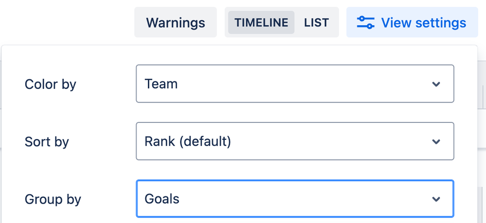

Also you can group by Goals from View Settings
