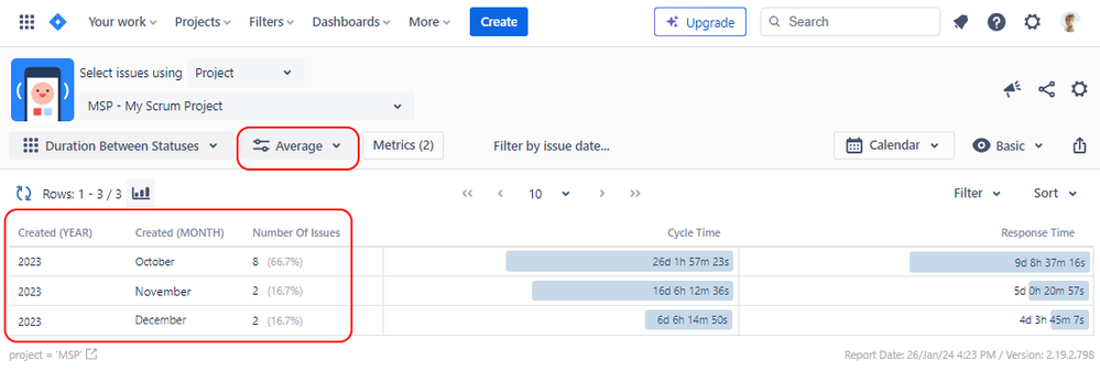

@Chuck Oleary has already mentioned the application which is built by my team at OBSS, but I want to give you a little bit of more detail about it. Timepiece - Time in Status for Jira by OBSS is a very advanced tool with which you can easily access the cycle time in your JSM projects as you request.It is available for both  Jira Cloud, and Data Center.
Time in Status mainly allows you to see how much time each issue spent on each status or each assigneeYou can combine the time for multiple statuses to get metrics like Cycle Time, Resolution Time, Issue Age, Lead Time etc. (Please see the screenshots below)
For all numeric report types, you can also calculate averages and sums of those durations grouped by the issue fields you select. For example total in-progress time per customer or average resolution time per sprint, week, month, issuetype, request type, etc. The ability to group by parts of dates (year, month, week, day, hour) or sprints is particularly useful here since it allows you to compare different time periods or see the trend.
The app calculates its reports using already existing Jira issue histories so when you install the app, you don't need to add anything to your issue workflows and you can get reports on your past issues as well. It supports both Company Managed and Team Managed projects for Jira Cloud.
Time in Status reports can be accessed through its own reporting page, dashboard gadgets, and issue view screen tabs. All these options can provide both calculated data tables and charts.
Gadget_AverageStatusDurationByComponent.png   tisCloud_IssueView_Data.png   tisCloud_StatusDuration_LeadTime_Chart.png

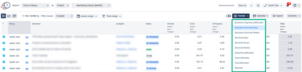

Hi @Simon Hancock   👋
Unfortunately, there is no way you can find with native features, but you can achieve it with Time in Status for Jira by SaaSJet.
You can view data as a Table or Chart. And use a Pivot to customize your reports as you need.
The Format option lets you select the time format of status duration. One of them is
  • DaysHoursMinutes
  • Decimal Days
  • Business Decimal Days
Also you will be able to create the Cycle time report easily and display it on your board
Moreover, you can export all necessary data as a report in XLS or CVS files and set up a teamwork schedule to exclude non-working hours or days.
