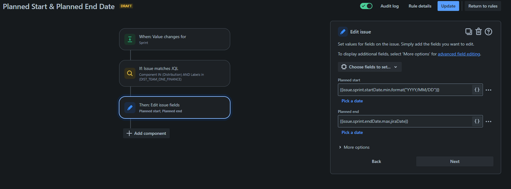

I am attempting to create an automation that will automatically populate the 'due date' and the Planned End Date with the Sprint End Date for that issue when the Sprint is added or changed. I have tried all of the formulas below and I either get nothing, I get the date of the last sprint created but if I chose any other sprint I get "Jan 01, 2024" or one of the errors below:
Trigger:
When value changes for the Sprint field -->
Due Date
{{Issue.Sprint.endDate.format("yyyy-MM-dd")}}
{{Issue.Sprint.endDate}}
Planned End Date:

Hmm, can you share your rule screenshot, especially the step where you are updating the fields..

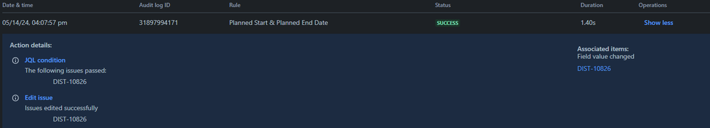

It did not work for the "Planned start date" & "Planned End date" fields The audit log says it was successful however nothing was populated in those fields. Audit log.PNG

Have you logged {{issue.sprint.endDate}} date to see if this issue has 1 sprint end date or multiple?
Cause if this issue was part of multiple sprints, this smart value is a list which you are trying to assign to a date field. So instead you may need to use {{issue.sprint.endDate.max}}
Can you please log these values before updating your fields and share your rule / audit log?
