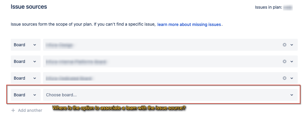

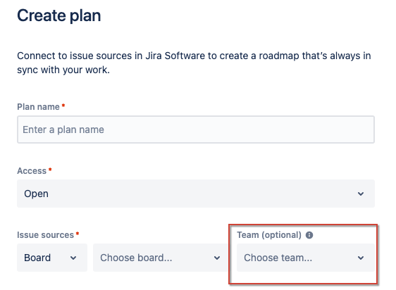

Assume I am using a plan with two boards as issue sources.  When I created the plan I was able to associate the issue sources with teams.
I am able to associate teams with issues and see capacity on the timeline. Yay!
Now I add a third board to the plan.  Advanced Roadmaps does not allow me to associate a team with the issue source.
As a result, even if I associate every issue with a team, the sprint information does not appear on the timeline, and capacity planning fails.

  1. Why isn't AR showing capacity when sprint values and teams are associated with the issues?
  2. How can I associate a team with an issue source added after a plan has been created?  How do I fix this?

Curt Holley
March 30, 2022
Hi @Rob Horan
Go to the roadmap views and select Teams. click the the more options (the 3 dots) on the team required and select Edit. From there you should be able to add or edit the issue source for the team.
