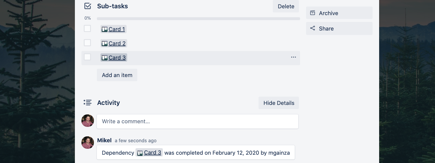

Hi all,
I have a "butler" question. I am trying to do task dependencies, as explained in  https://help.trello.com/article/1165-task-dependencies  but the checking the item part when a linked card is completed is not working for me.
When the card is moved to "Done (...)" the comment is posted in the linked card but the item does not getchecked...
That means that it can find the linked card, but for some reason {triggercardlink} does not get checked
You can see it in the screenshot below
Any ideas? Thanks!!!

Execute the rule, then from butler panel, go to Account 》》Usage Log. Can you give a screenshot of the log ?
You will see an error, if not, you will see a trace like this
I completed item "https://trello.com/c/jZP" of checklist "Sub Tasks" in card https://trello.com...

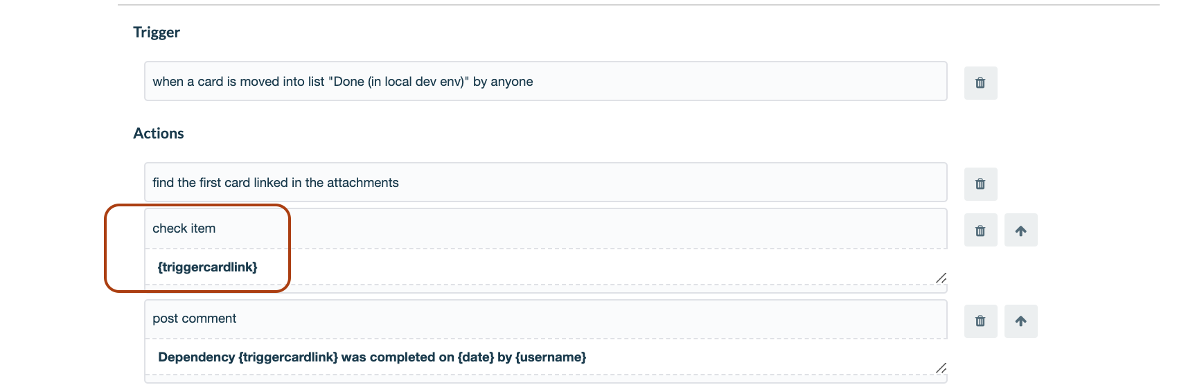

Gain February 13, 2020
thanks for your reply Ludo!
it seems that the {triggercardlink} is looking for https://trello.com/c/KLbcMfaS   instead of https://trello.com/c/KLbcMfaS/28-card-1
As a test, I modified the query to manually look for https://trello.com/c/KLbcMfaS/28-card-1 (not using triggercardlink)... and it worked
How can I fix this issue and tell butler that {triggercardlink} should be the full URL [ triggercardlink + triggercardname] ?

Gain February 27, 2020
Trello support got back to me, and they could reproduce the problem on their side
{triggercardlink} uses the card shortURL (without the card title at the end. So, the checklist item uses the full card URL (including the card title), it won't work
They will contact the Butler team to find out whether that is normal behaviour or a bug
