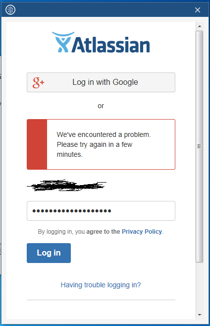

×I've tried to install SourceTree (2.1.2.5) on Windows 7 several times over the last two days. It always gives the message "We've encountered a problem. Please try again in a few minutes." in step "Atlassian account" (see attached screenshot). I try to login with my Atlassian Id. Id and password are correct (I've used the same to login to ask this question).
What is the problem that has been encountered? When will this problem be fixed?
To every one, try "Reset your Internet Explorer Settings" in IE internet option advanced tab, also check "Delete personal settings"

Unfortunately at the moment we are restricted by the default .NET/WPF WebView for the registration process and this relies on IE and its settings.
We are investigating alternatives at the moment,

Hi @John Bagagem! The one you're reporting is a different issue. That one has been reported in our bug tracker at SRCTREEWIN-7244. This workaround seems to be working for most of the users:
From a working install collect the accounts.json and passwd files.
Delete the Atlassian folder from the AppData/Local directory for your user. Run the installer for 2.3.1, close it when you get the blank login window. Place the account.json and passwd files into the Atlassian/SourceTree folder. Rerun the installer. It should detect the account and password from those files and bypass the request for a login.
Note that in order to be in compliance with the Atlassian EULA you must ensure the email address used in the file is valid, yours and associated with a valid Atlassian account.
In the meantime, our developers continue to work with the id.atlassian.com team to implement a proper fix.
Let us know if it worked for you!

This didn't resolve the issue for me. I did some debugging and even though the error message is provided in the response AJAX message, it's not displayed in the UI (why?)
The error is "Origin header required." Not currently sure hwo to force IE to send this, starting to wish the install size increased by 50MB to embed CEF or Chromium.

Internet Options (or Internet Properties) -> [Advanced] tab
`Security
` Do not save encrypted pages to disk (uncheck the checkbox)
OS : Windows 7 pro SP1(64bit)
IE : 11 (11.0.9600.18792)
SourceTree : Ver. 1.9.6.1, 2.3.1.0
etc : domain network, under proxy, with anti-virus software
I hope this helps.

I solved it in the following way.
Internet Explorer > Internet Options > General > Browsing history Settings
Set the storage location of temporary files somewhere in the folder.
Confirm. Thanks
Hello everyone, our identity team is still working on this issue. However, if you're having this problem, could you try changing your Internet Explorer Security Zone Settings?

Hi Christian, just to check can you login directly to Atlassian account https://id.atlassian.com using IE? SourceTree relies on the WPF web view that relies on IE. Please let us know the result!
Regards,
Ana
Hello Ana, thank you for your Reply. I can successfully login to Atlassian account https://id.atlassian.com using IE11. Trying to finish the installation of SourceTree with the same credentials still failes.
