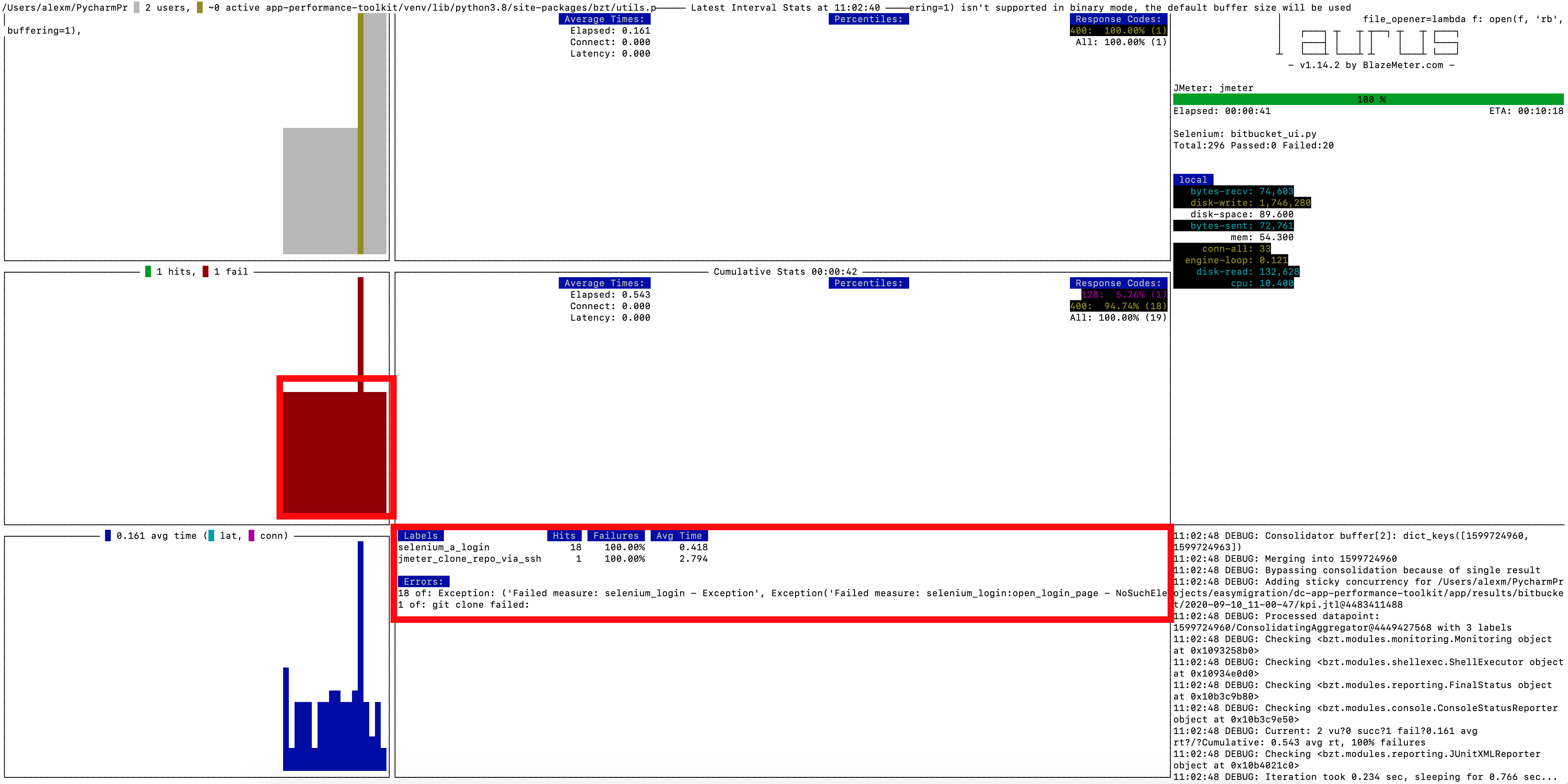

I ran dc-app-performance-toolkit on a Bitbucket instance and during the run I could see many errors with Selenium scripts:
As you can see I have 100% errors with selenium_login script with the NoSuchEle error.
How to understand what went wrong?

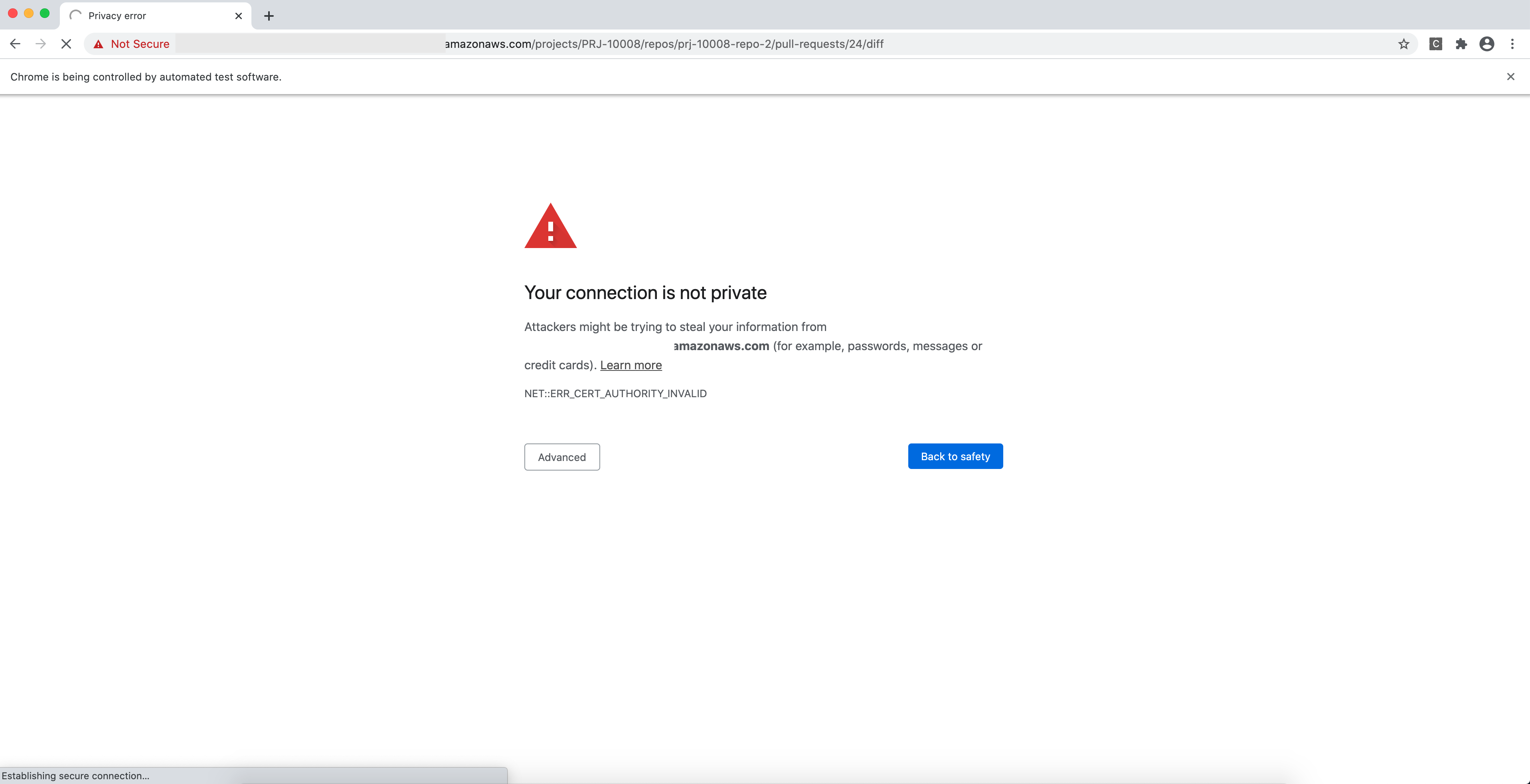

I set this parameter to True and here is what I saw:
Now everything is clear. Selenium thinks that the first page will be the Log In page but instead we have a error. Selenium tries to find the required element and can not find and throws an error as the result.
Well, now we understand what is going on. Let's fix it.
